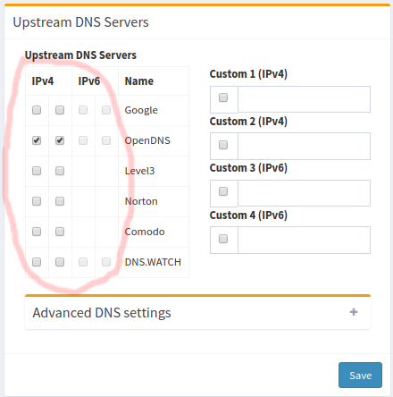

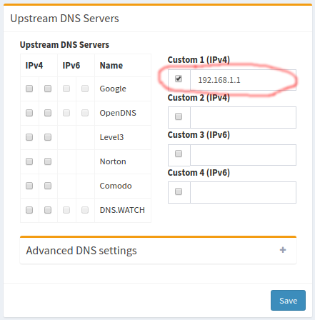

On Pi-hole, login to the web interface (http://pi.hole) > Settings > DNS and instead of choosing upstream servers like Google or OpenDNS, set the upstream to be the IP address of the router as the only upstream DNS server. Do not define any other DNS entries for Pi-hole:
