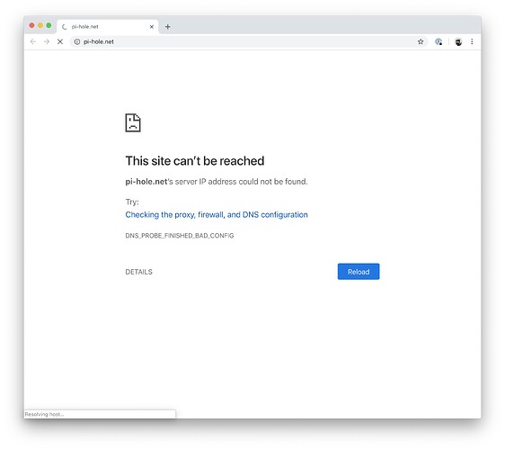

Essentially, as soon as I set it that way (Which is to say, manual DNS address to my pi-hole DNS at 192.168.1.### and then fetch a new DHCP lease on my Mac, it essentially breaks a number of items including the ability to access http://pi-hole.net/ which just stops loading entirely on both Chrome and Safari. As soon as I remove the pi-hole DNS it starts to work again.

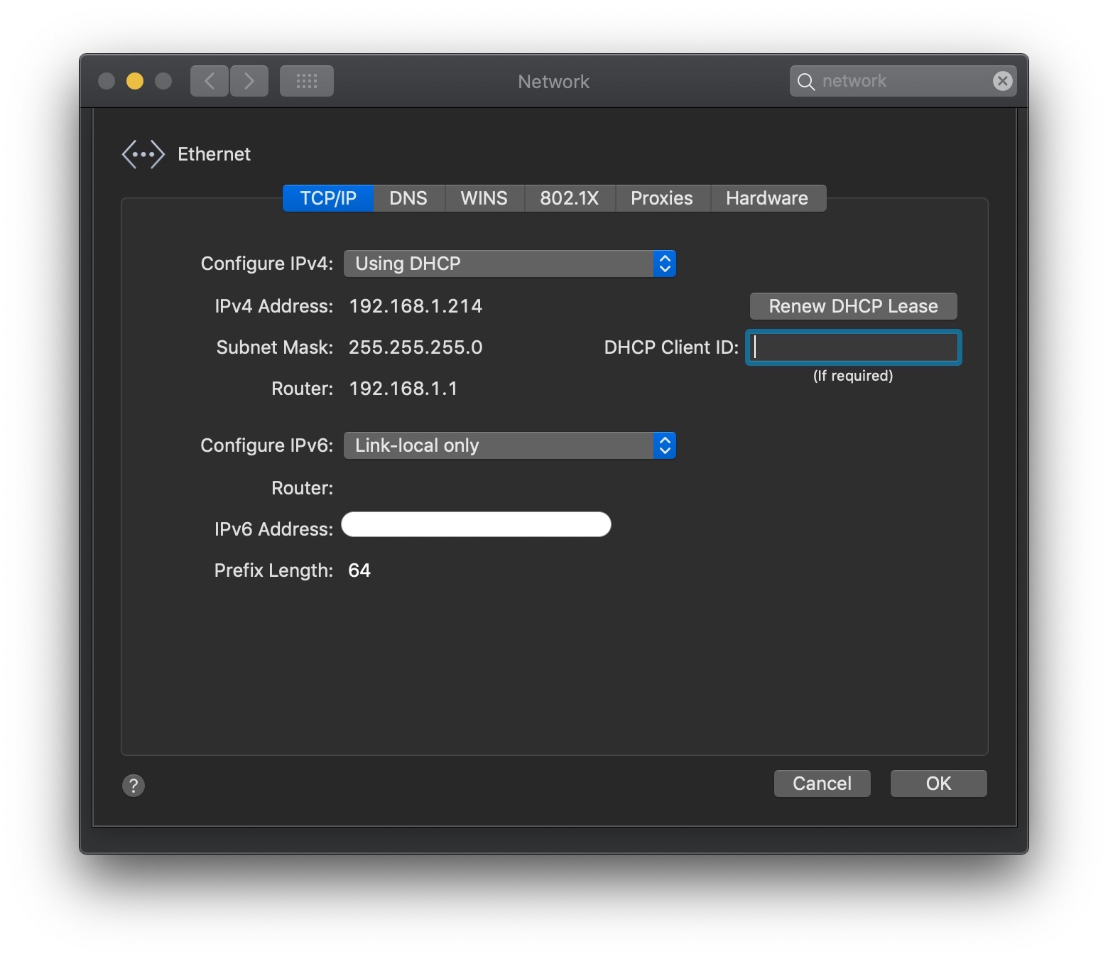

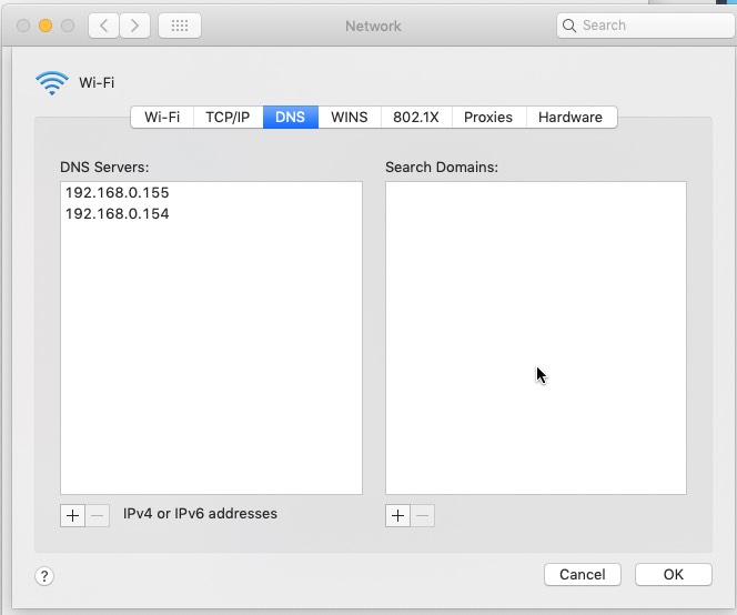

Let's try to get a single client working on it. On the Mac, what are you seeing in your DNS tab on network settings? In the example below, both of the IP's are Pi-Holes, manually set.

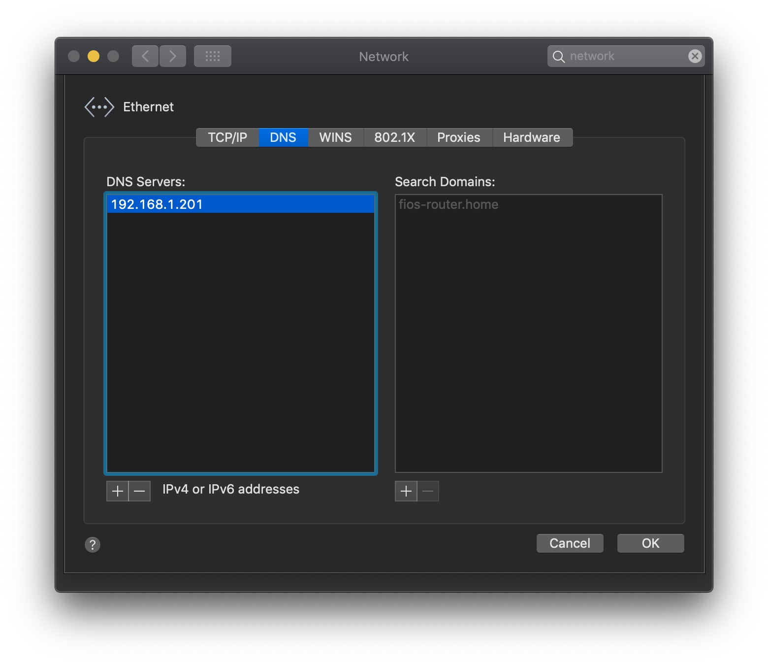

Here are the DNS settings, I am unable to remove the search domain that is set.
The Pi-Hole is working properly. The problem appears to be in your router, which is likely providing another DNS service.
What do you see on this screen:
See attached
