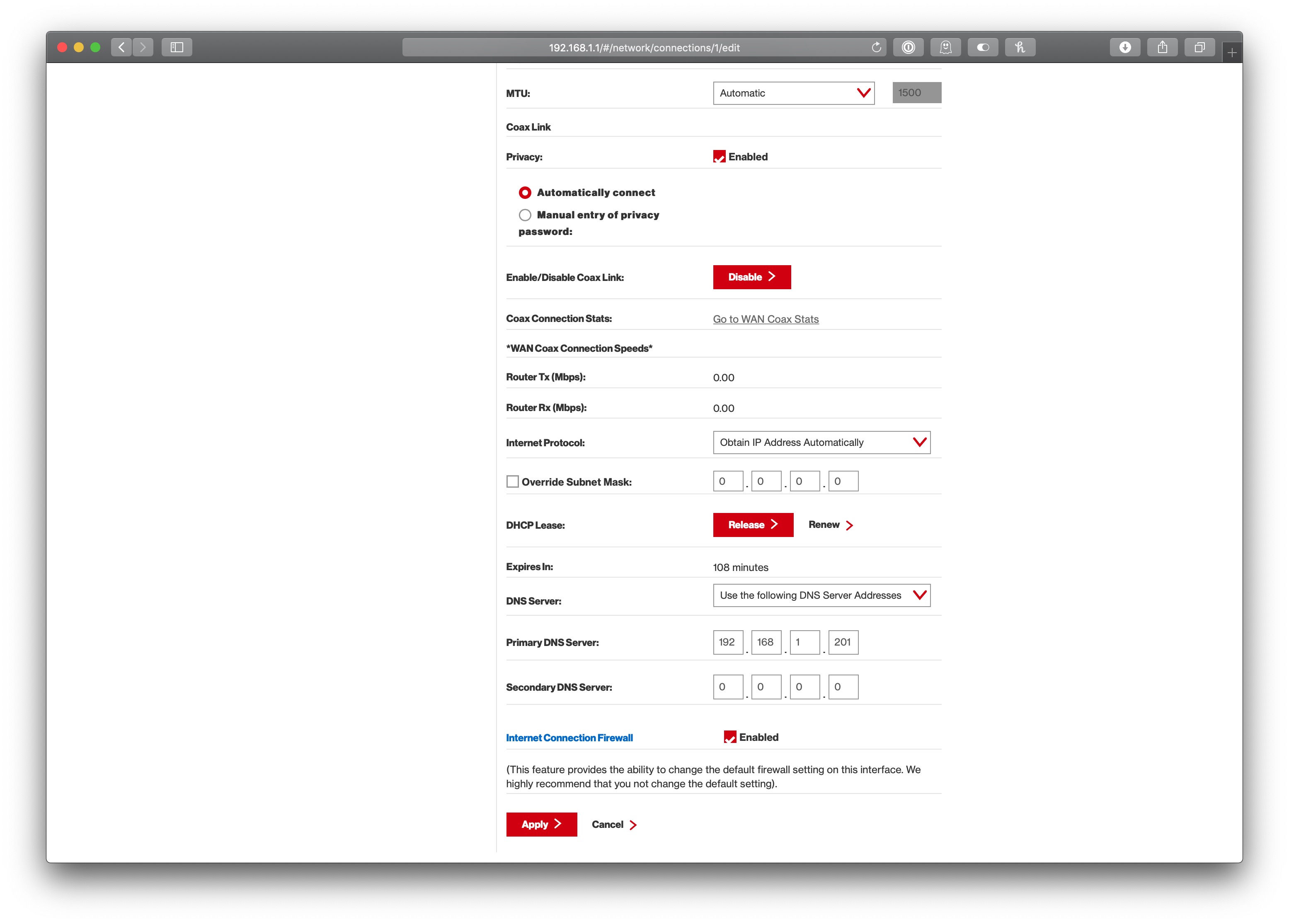

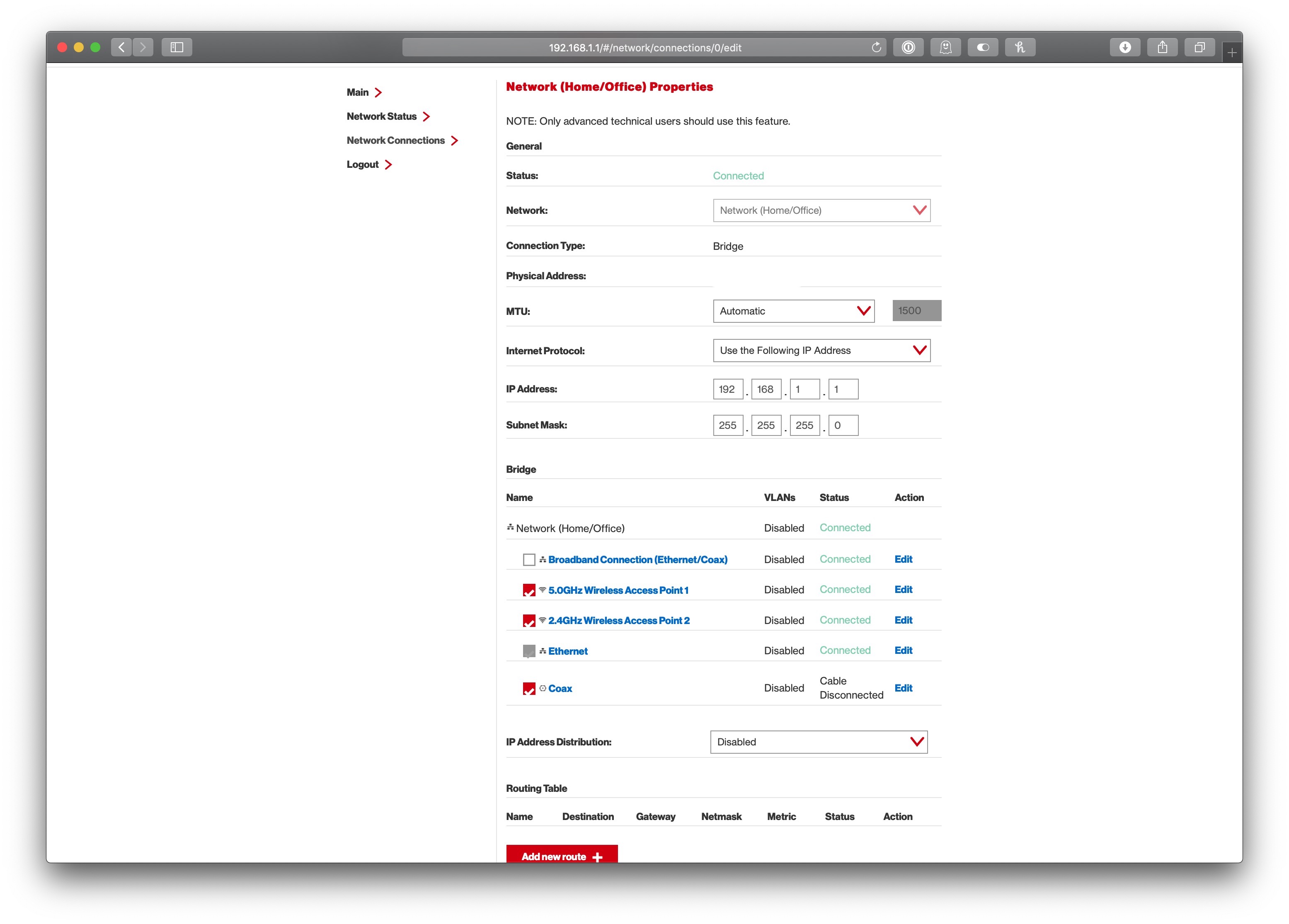

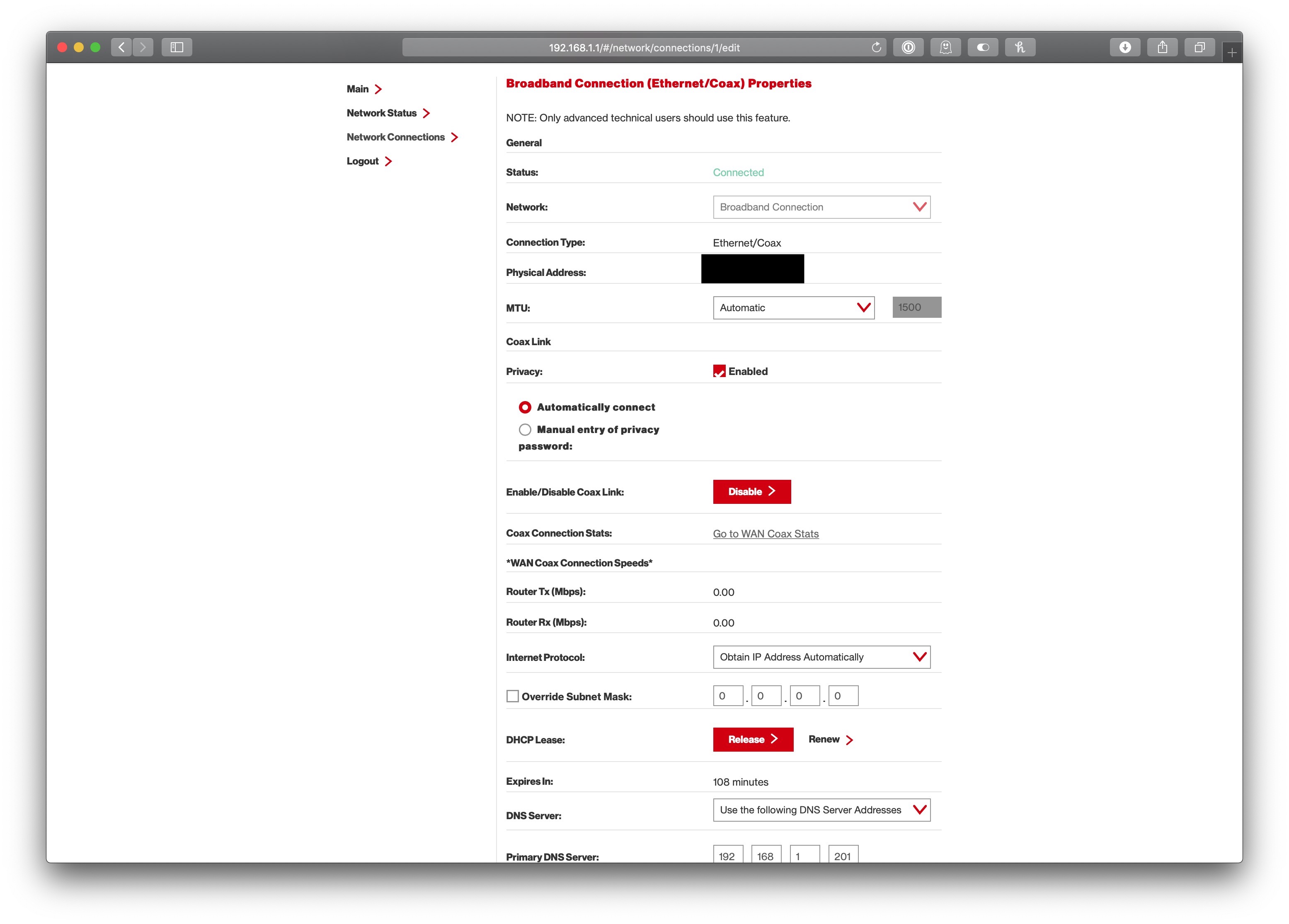

Confirmed that it is all off, and went through and verified router settings. Everything should work:
Broadband:
Network:
