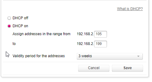

I've been trying repeatedly to setup Pi-hole network-wide, but I keep running into the same stuff. I watched people with the same Router that I own, did everything they did, just to find someone else's guide and start all over again. I've tried all 3 methods listed in this guide: How do I configure my devices to use Pi-hole as their DNS server?
Router
  • DHCP on
  • local IPv6 address (ULA)
  • Fixed DNS server address (primary DNS towards Pi, secondary towards 8 8 8 8 (Google))
  • Sometimes I can't reach my Router's web page, it's random

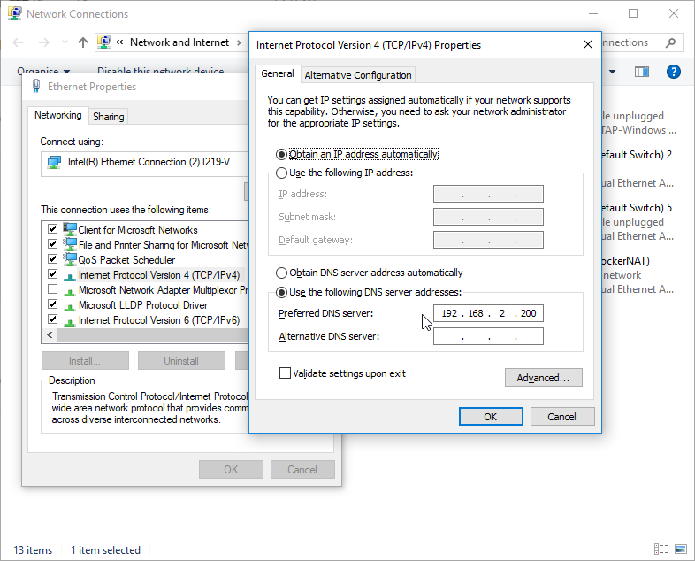

Thank you for your help. I just had to point my adapter towards the Pi again, because I lost the connection, as soon as I made these changes to my router. According to Windows I still had internet access through, I just wasn't able to reach any website.

What adapter is this?
That's the static Ip of the Pi
That client is manually mapped to the Pi-Hole. What is the result if you check "Obtain the DNS server address automatically" and apply that setting? That will show the DNS that is being provided by the router during the DHCP handshake.
That will unfortunately get me semi-offline again where I can't reach any website
What is causing this? When you get the DNS automatically, what DNS are shown in the Windows box with ipconfig/all?
I don't know. That's what keeps bugging me...
>>ipconfig/all
Your router is passing itself and an IPv6 DNS to the client, and not the Pi-Hole DNS address. If you aren't using IPv6 on your network, I would disable that on the router and clients. That has frequently been a source of DNS bypass around Pi-Hole.
