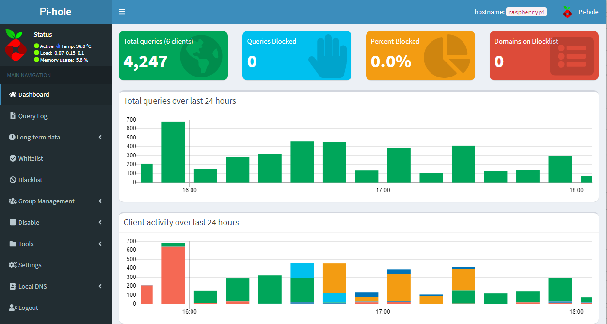

I've recently tried to install Pi-hole to block the adds on all the devices in my house, but I'm unable to make it work. Everything seems to be installed correctly but no add is getting blocked and the dashboard shows that there are actually 0 queries blocked:

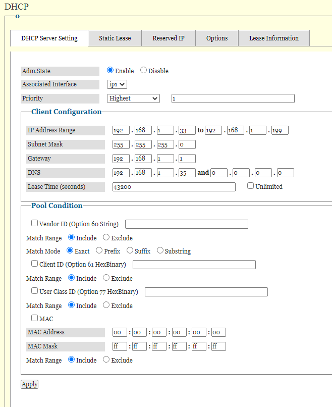

I guess it has to be an issue with how I need to configure the router. I've followed this guide and set my DHCP/DNS settings like this:
I've restarted the router and all the devices but it does not work. I'm a total disaster at everything related to networking so I don't know what I'm doing wrong or what else I need to do.

You have 0 "Domains on Blocklist" so there is nothing to block.

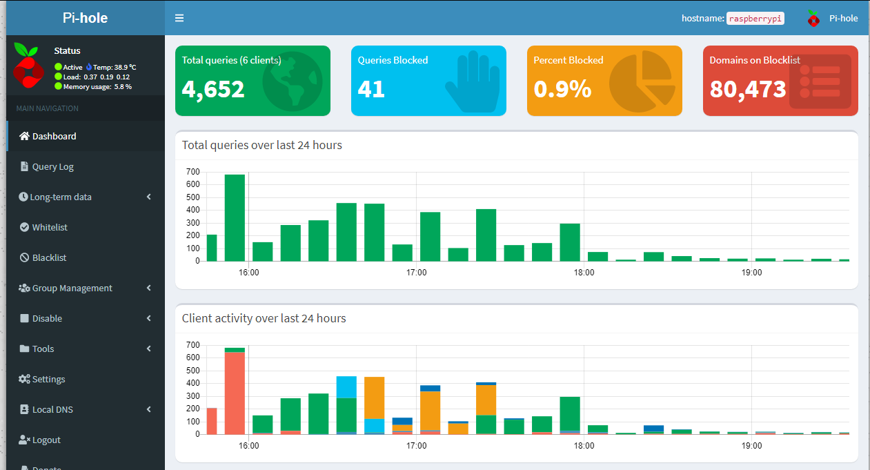

Your solution seems to work. Now I can see that there are domains on the blocklist and there are some queries blocked:

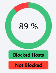

The problem is that I don't see any difference in terms of adds. I've tested some websites and the adds are still there. I've also tested with this site and the blocked hosts are the same as before. Is there something else I need to do?
Cache is everywhere.
Try reboot a test client.
