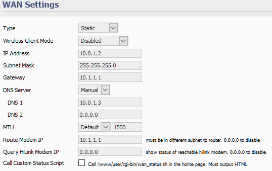

From Tomato Router with googledns as secondary there is internet | If i removed google dns and restarted or release&renewed the whole network internet breaks:

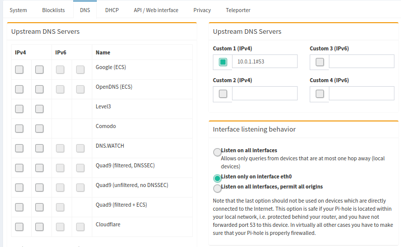

From PiHole DNS settings:
https://tricorder.pi-hole.net/5jjxvg5cn4

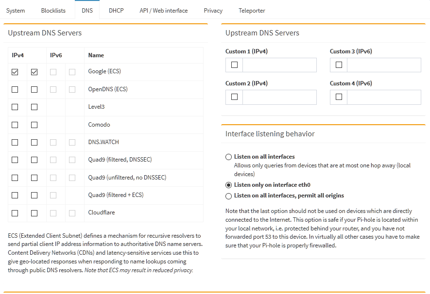

I ditched using my router ip as custom Upstream DNS Server. And used Google(ECS) for upstream, PiHole IP is being advertised from all devices, no secondary(googledns) just in pihole, everything seems to be working fine, doesn't break the internet after reboots (took just a little while to comeback, but it works fine)

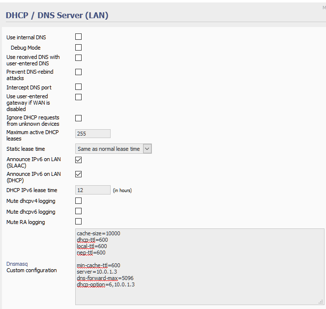

[ROUTER]
I set PiHole IP for primary. (Typo 10.0.1.2 , it should be 10.1.1.2)

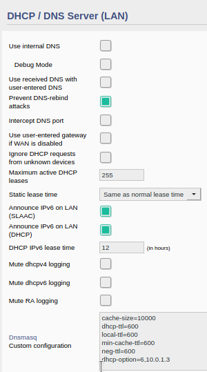

Added these commands on my DNSMASQ
(Got the reference from this guide )
server=10.0.1.3
dns-forward-max=5096
dhcp-option=6,10.0.1.3

  1. Do you really have a static IP assigned from you ISP on WAN for 10.0.1.2
  2. Your Gateway has 10.1.1.2 which is outside of your subnet mask (see the additional 1)
Technically it is working.
  1. ISP(DHCP: 10.1.1.1) is connected to routers wan(STATIC:10.1.1.2)
  2. Ah. that was a typo, was fidling my network during troubleshooting its supposed to be 10.1.1.2 ::facepalm::
I noticed something really weird. When using GOOGLE(ECS), I find "Total Queries" increases really quick (like reeeeaaaallly quick.. in 10mins i have like 100k entries). So i flushed the pihole logs "pihole -f" , changed to cloudfare dns and Total Queries stops from increasing rapidly.
Any thoughts of this?

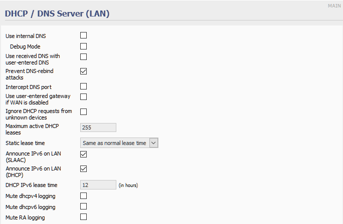

Think I unticked "Prevent DNS-rebind attacks" by accident, somehow it slows down the rapid increase of total queries. :upside_down_face:
