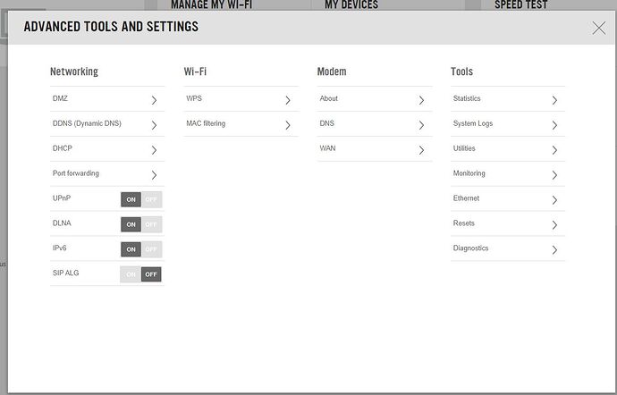

Here are the Advanced options in the router:

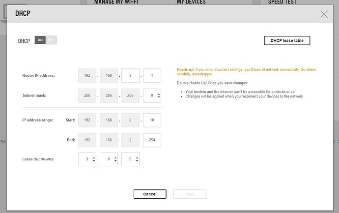

The closest correspondences seem to be Advanced > Networking > DHCP:
I tried resetting the Router IP address to the reserved address for the Pi, which was a disaster, and I wound up having to factor-reset the router and set up the house again.

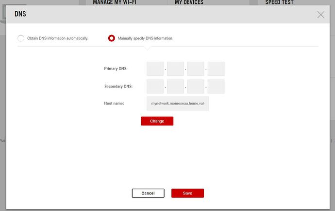

Under Modem > DNS, there is a way to manually configure the DNS information, but I only have the pi-hole's IP address, not a secondary address or name. All three are required for me to save changes on this screen.
Should I set up the Pi as the first DNS address, with 8.8.8.8 as a fallback on the latter screen -- if yes, what should that name be?
Leave the "Under Modem > DNS" setting on factory defaults.
You're lacking a Advanced > Networking > DHCP > DNS server(s) setting for a proper setup.
But it seems you can disable the DHCP server with that ON/OFF switch.
