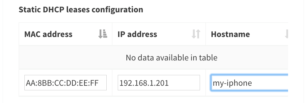

Use Pi-hole's DHCP server
When you enable Pi-hole's DHCP server, you have the option to assign DHCP reservations and pair them with a hostname. Just make a reservation for every device on your network.

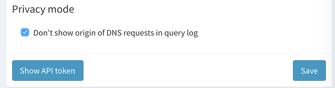

Privacy Settings
Please note that for either option above, if you have the privacy mode enabled, the hostnames will not show in the dashboard.
