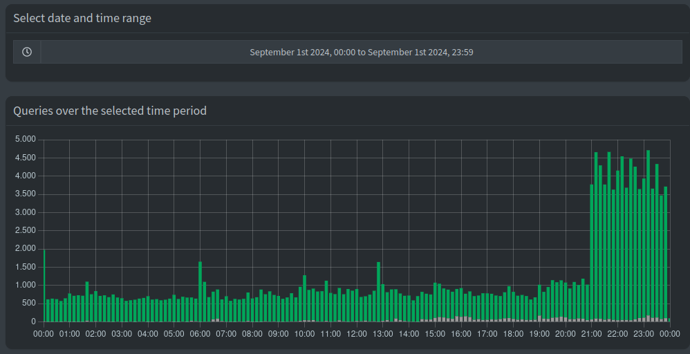

Up until yesterday night I had around 5.000 queries per hour, which sounded normal. Many of the queries were reported from PiHole as coming from the IP of OpenWrt APs and I wanted to see the actual IPs making the queries so I tried editing the configuration.

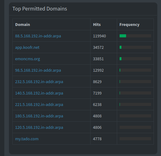

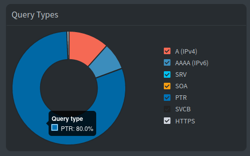

Long story short, up until yesterday night I had around 5.000 queries per hour, now I get around 25.000, most of which (around 80%) are PTR queries to local IP addresses.
I have attached the debug token below. Please find also a couple of extracts from Tcpdump and PiHole log that may be relevant as well.
https://tricorder.pi-hole.net/tiGujYu3/

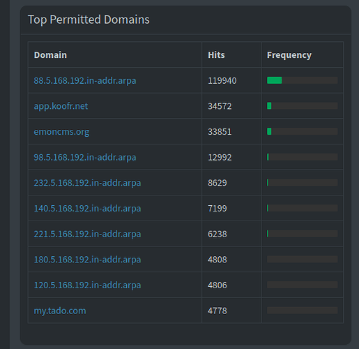

It looks like the PiHole (localhost or 127.0.0.1) is querying itself to get PTR of my whole local network. The PiHole replies with several NXDOMAIN as many devices are not really existing on the network. Most queries (around 120.191 as of now) are directed to 192.168.5.88 which is not in use (it is even out of the DHCP range of PiHole...).
