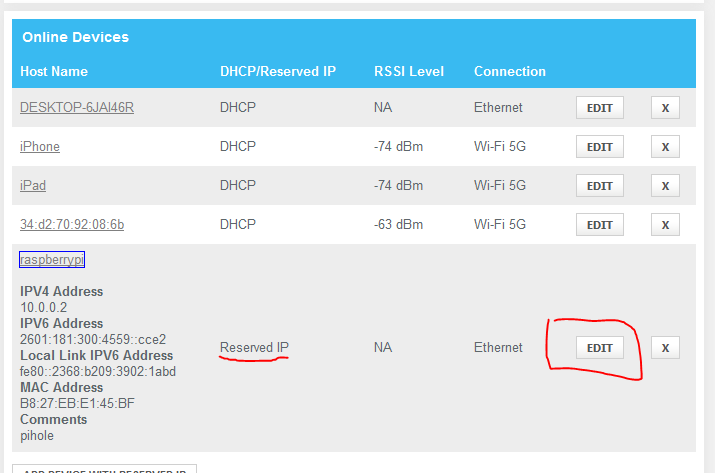

Looks like in your modem should reserve an IP address for your rpi. Generally I would always reserve over statically assigning it on the device. Here is how I did that on the xfinity gateway.

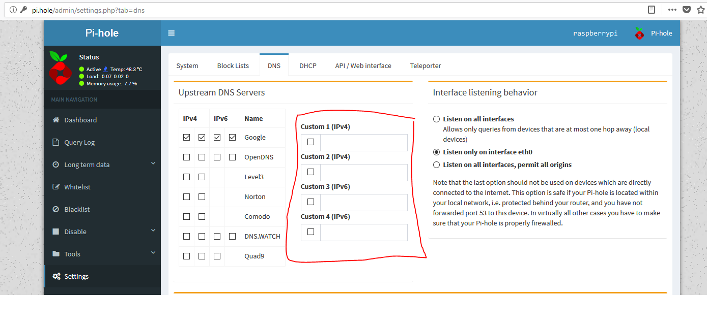

Here is something I noticed:
Pi-hole Ethernet Interface:|wlan0|
Pi-hole IPv4 address:|192.168.1.13/24|
Pi-hole IPv6 address:||
Pi-hole hostname:pi
That is from the GUI, why does it think the ip is 192.168.1.13/24 on wlan0 (wireless) when:
