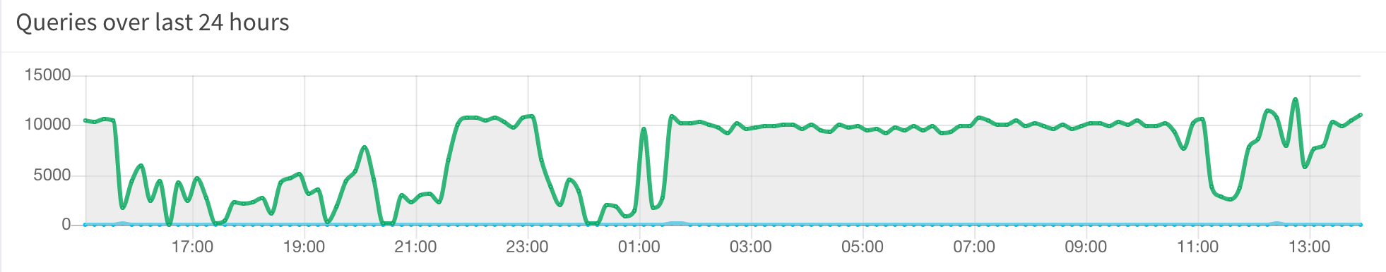

I've got a domain that keeps being queried and forwarded in my logs. I can see the queries ramp up for several hours at a time and there's hours long table top graphs in my dashboard.
Here's an example of one from 1am to 11am:
It may have dipped down because I started reconfiguring and restarting stuff to see if I could fix it.

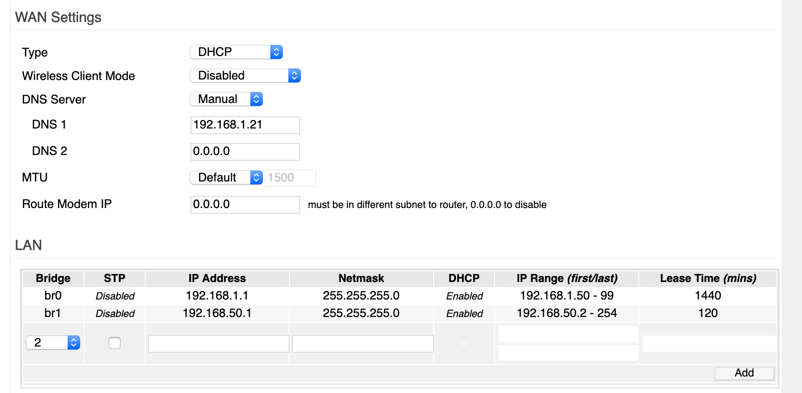

In Tomato - Basic > Network:

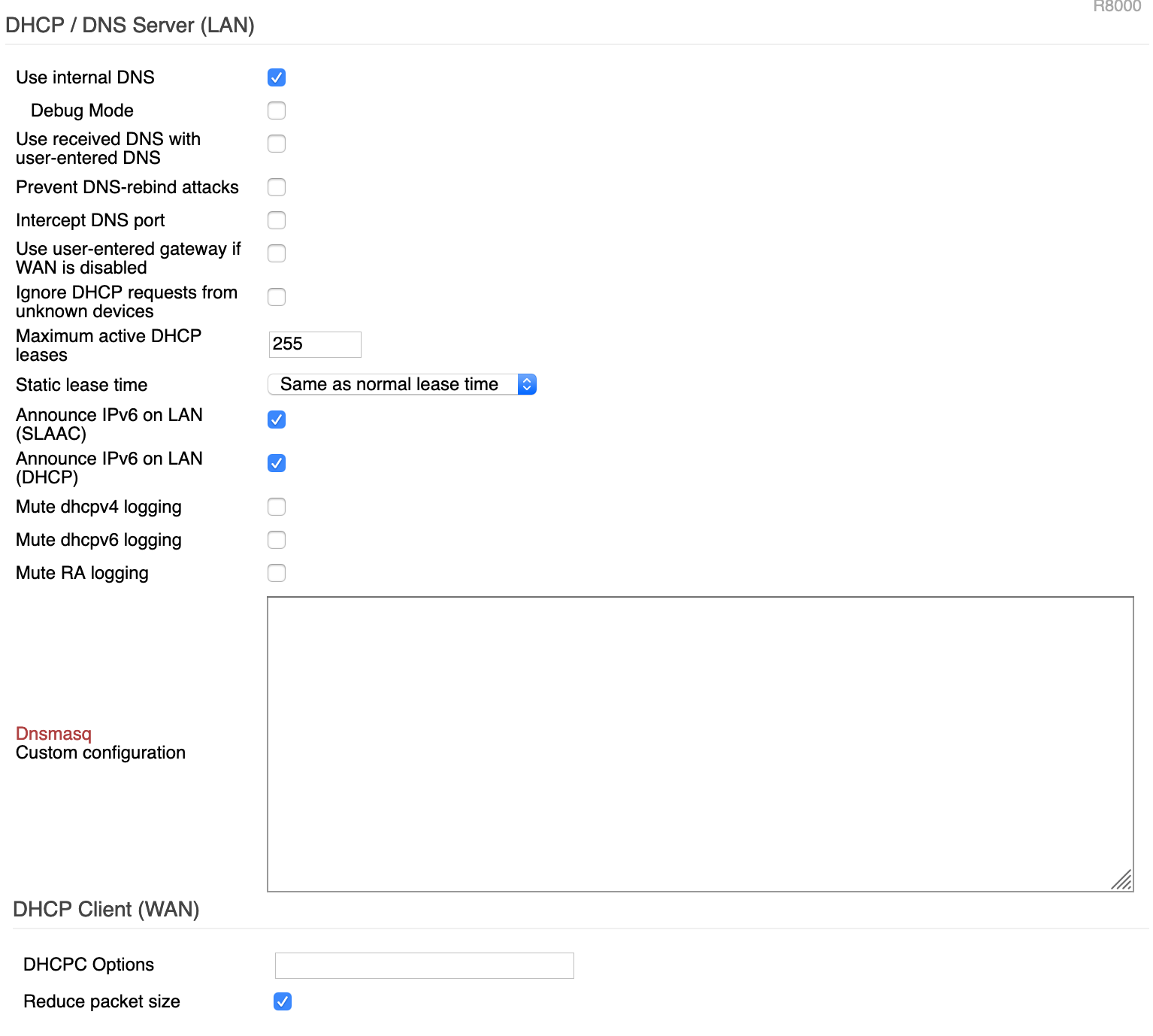

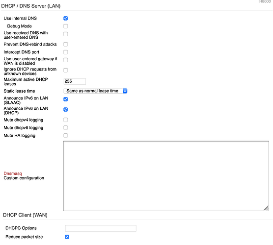

Under Advanced > DHCP/DNS:

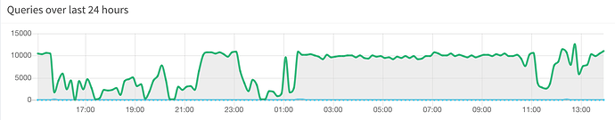

So far I've got about 6000 queries every 10 minutes.

I would turn this off. It can result in a lot of loop traffic, particularly with DNS-DS requests like shown in your log.
That seems to have brought things back to normal.
