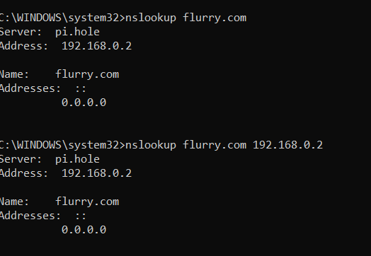

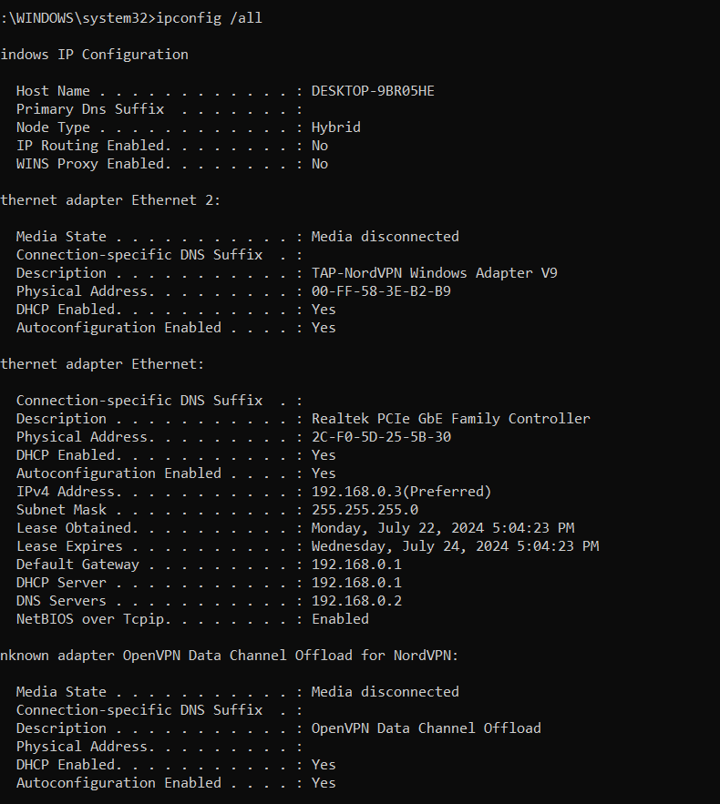

I have the same exactly issue. On all my Apple devices working fine but on Windows PC the number of querries is lke 1% of th total... but in the Dashboard the PC is green. I did run the ipconfig /all here is my response.. what exactly do you need ?
