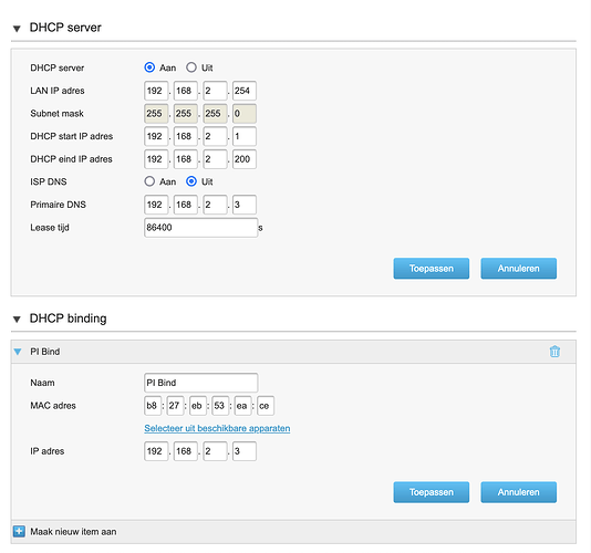

This is the info screen under LAN

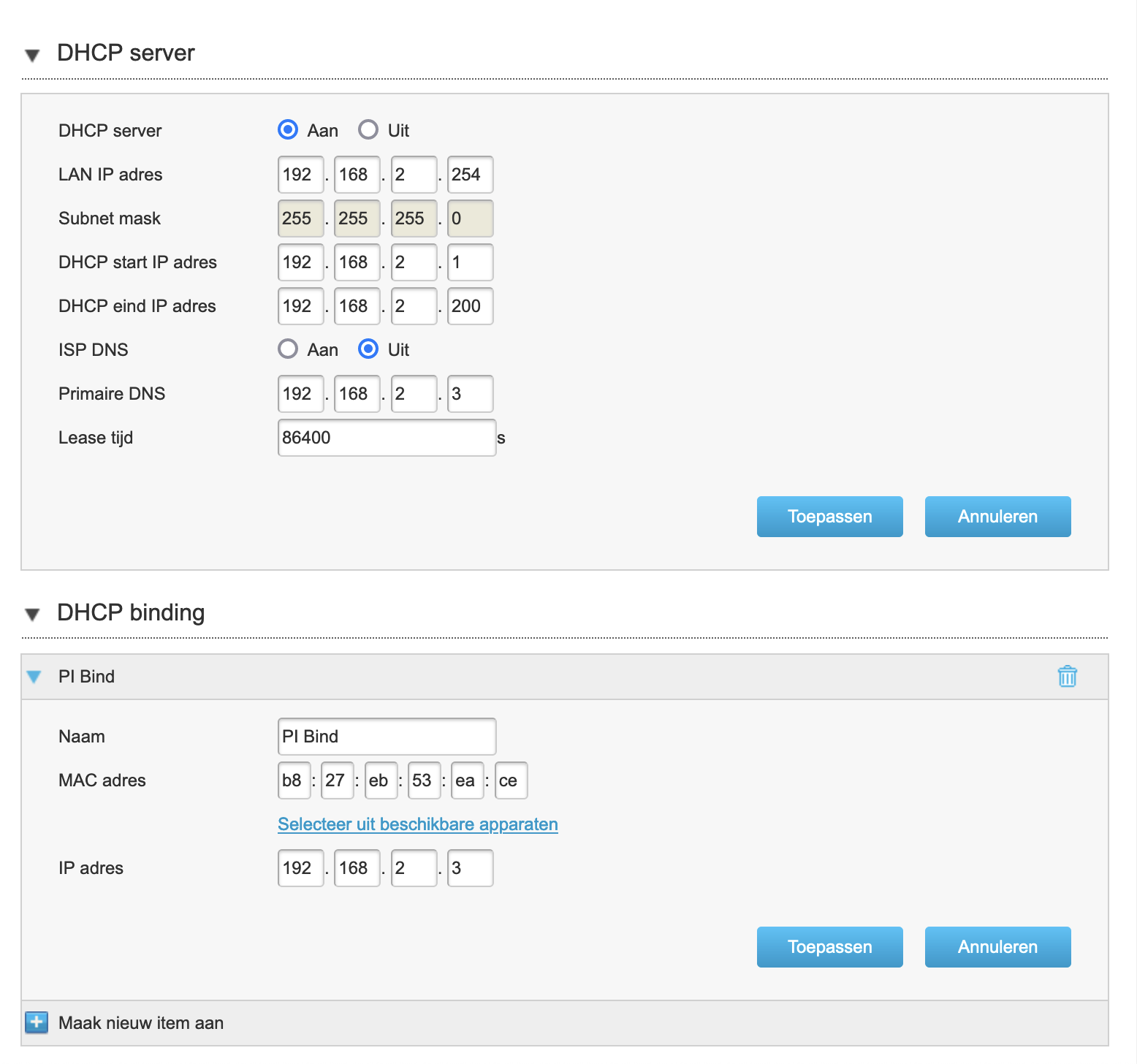

Under settings itself (it doesn't say LAN explicitly, but there is WAN stated in a different screen)
Hope this clarifies something
Default all other changes that you've made on the router and only enter the Pi-hole IP for "Primaire DNS" in the "DHCP server" section from the screenshot.
Plus "ISP DNS" = "uit" should do the trick.

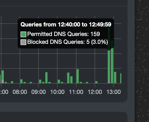

It does seem to block some things btw, but not adds on Youtube (which I tested a couple of times, including restart):
Your router with IP 192.168.2.254 is advertising its own IP for DNS to the clients alongside the Pi-hole IP 192.168.2.3.
This means that clients can bypass Pi-hole:
If you cant get the routers DHCP service to only advertise the single Pi-hole IP for DNS, you could opt to let Pi-hole take over DHCP services for your LAN:
EDIT:
Oh Youtube ads cant be blocked as the ads are coming from the same domains as where the content is coming from.
A browser ad blocking plugin can fill that gap or get a Youtube premium subscription.
First of all, thanks for all the effort you're putting into helping me: much appreciated!
Secondly, as for getting the router to only advertise the Pi-hole IP for DNS: I've now set the Pi-hole to take over the DHCP services. This seems to work. I've re-run sudo pihole-FTL dhcp-discover by the way and this produced the following output:
