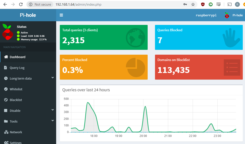

Here's a screenshot of the admin console taken from my desktop just to show it is loading and shows the now 3 connected devices
Check the output of these and see if the expected clients are connecting:
echo ">top-clients" | nc 127.0.0.1 4711
echo ">top-domains" | nc 127.0.0.1 4711
