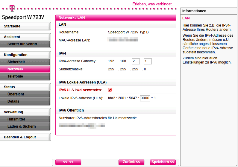

Deutsche Telekom - Speedport W 723V
Deutsche Telekom - Speedport W 724V

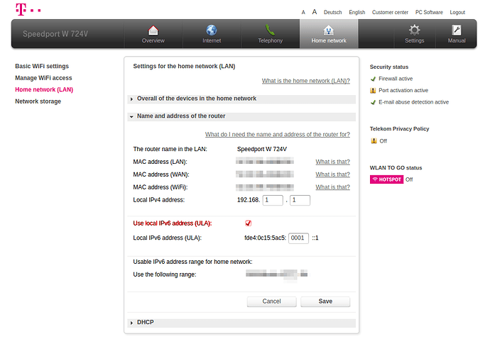

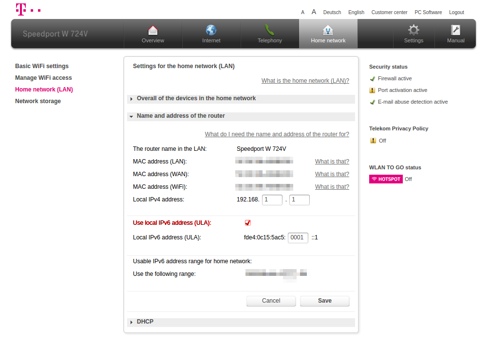

For all users of the Speedport Hybrid router by Deutsche Telekom: take a look at the above screenshot for the Speedport W 724V, it's the same as for the Hybrid.
Home network -> Home network (LAN) -> Name and address of the router -> Use local IPv6 address (ULA)
