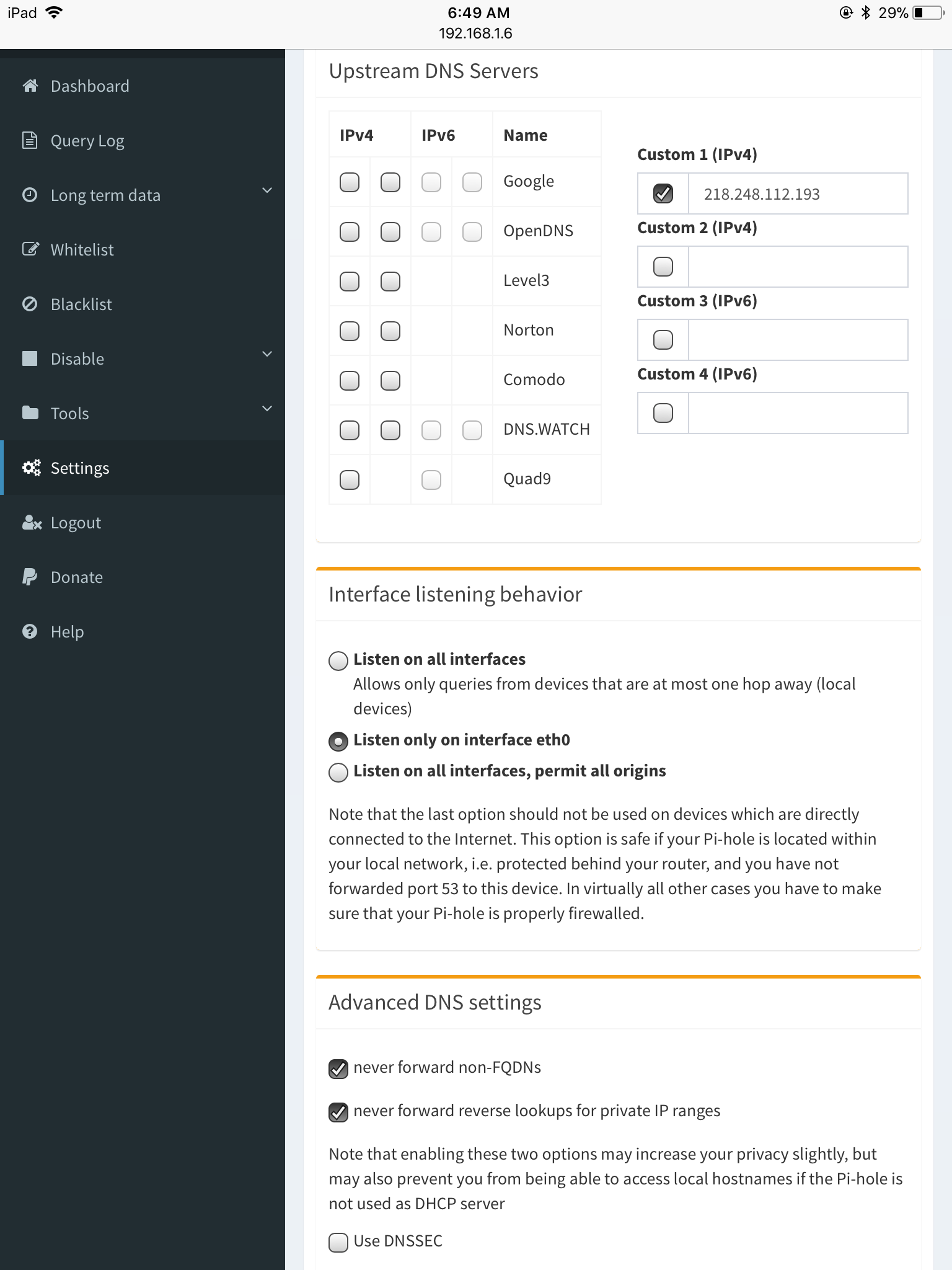

Hi, i have been using pihole for about a week now and everything seems to work great except a minor problem. whenever the system is rebooted none of the other devices connected to my home network would connect to internet unless i ssh and manually run the command [pihole restartdns].
before the dns restart process i can ping to any ip address successfully from the orangepizero (ubuntu 16.04 LTS) machine which is running pihole. i have also configured a static ip for pihole from my router’s dhcp settings.
just to be sure dnsmasq service is starting correctly i added these two lines to /lib/systemd/system/dnsmasq.service as mentioned by other threads:
After=network-online.target
Wants=network-online.target
tried [sudo systemctl edit dnsmasq] and did the same thing but no result.
next i tried to edit the rc.local file to automatically restart dns service [pihole restartdns] after each boot but even this did not work.
here’s my pihole dns settings:
just fyi i am using a custom dns address provided by my isp and wifi is always switched off.

[i] Default IPv4 gateway: 192.168.1.1
  • Pinging 192.168.1.1...
    [✓] Gateway responded.
[139] is in use by smbd
is in use by
[22] is in use by sshd
[445] is in use by smbd
[80] is in use by lighttpd
[8200] is in use by minidlnad
is in use by
[53] is in use by dnsmasq
[✓] yeshhaod.com is 192.168.1.6 via localhost (127.0.0.1)
[✗] Failed to resolve yeshhaod.com via Pi-hole (192.168.1.6)
[✓] doubleclick.com is 172.217.166.78 via a remote, public DNS server (8.8.8.8)
[✓] dnsmasq daemon is active
[✓] lighttpd daemon is active
[✓] pihole-FTL daemon is active
DNSMASQ_LISTENING=single
DNS_FQDN_REQUIRED=true
DNS_BOGUS_PRIV=true
DNSSEC=false
PIHOLE_INTERFACE=eth0
IPV4_ADDRESS=192.168.1.6/24

Below one will display status for the dnsmasq daemon:
sudo systemctl status dnsmasq -l
Note the one line that resembles below from the status output:
Loaded: loaded (/lib/systemd/system/dnsmasq.service; enabled)
If it mentions "disabled" instead of "enabled", you can enable dnsmasq to be started at boot with below one:
sudo systemctl enable dnsmasq
yes dnsmasq is active at boot up. i can even ping any ip. it’s just other devices won’t connect to internet unless i specifically run pihole restartdns or pihole enable.
"active" or "enabled" on that one line I pointed out ?
Could you reboot Pi-hole, login and first thing run below one and post the outcome here please ?
From the debug output "*** [ DIAGNOSING ]: Pi-hole log" , it seems no new log lines were added after Jan 25.
Disk full maybe ? Could you post outcome from below one ?
df -h
Or maybe another DNS daemon active ? Whats outcome from below one ?
sudo netstat -nltup | grep "Proto\|:53 "
● dnsmasq.service - dnsmasq - A lightweight DHCP and caching DNS server
Loaded: loaded (/lib/systemd/system/dnsmasq.service; enabled; vendor preset: enabled)
Drop-In: /run/systemd/generator/dnsmasq.service.d
└─50-dnsmasq-$named.conf, 50-insserv.conf-$named.conf
/etc/systemd/system/dnsmasq.service.d
└─override.conf
Active: active (running) since Wed 2018-02-07 08:02:27 IST; 4min 15s ago
Process: 1198 ExecStop=/etc/init.d/dnsmasq systemd-stop-resolvconf (code=exited, status=0/SUCCESS)
Process: 1244 ExecStartPost=/etc/init.d/dnsmasq systemd-start-resolvconf (code=exited, status=0/SUCCESS)
Process: 1236 ExecStart=/etc/init.d/dnsmasq systemd-exec (code=exited, status=0/SUCCESS)
Process: 1233 ExecStartPre=/usr/sbin/dnsmasq --test (code=exited, status=0/SUCCESS)
Main PID: 1243 (dnsmasq)
CGroup: /system.slice/dnsmasq.service
└─1243 /usr/sbin/dnsmasq -x /var/run/dnsmasq/dnsmasq.pid -u dnsmasq -r /var/run/dnsmasq/resolv.
Feb 07 08:02:26 orangepizero systemd[1]: Starting dnsmasq - A lightweight DHCP and caching DNS server...
Feb 07 08:02:26 orangepizero dnsmasq[1233]: dnsmasq: syntax check OK.
Feb 07 08:02:27 orangepizero systemd[1]: Started dnsmasq - A lightweight DHCP and caching DNS server.
Warning: dnsmasq.service changed on disk. Run 'systemctl daemon-reload' to reload units.
lines 1-19/19 (END)
df -h
Filesystem Size Used Avail Use% Mounted on
udev 212M 0 212M 0% /dev
tmpfs 50M 3.0M 47M 6% /run
/dev/mmcblk0p1 15G 1.6G 13G 11% /
tmpfs 247M 0 247M 0% /dev/shm
tmpfs 5.0M 0 5.0M 0% /run/lock
tmpfs 247M 0 247M 0% /sys/fs/cgroup
tmpfs 247M 0 247M 0% /tmp
log2ram 50M 27M 24M 54% /var/log
tmpfs 50M 0 50M 0% /run/user/999
/dev/sda1 224G 152G 61G 72% /media/seagate
tmpfs 50M 0 50M 0% /run/user/1000
sudo netstat -nltup | grep "Proto|:53 "
Proto Recv-Q Send-Q Local Address Foreign Address State PID/Program name
tcp 0 0 127.0.0.1:53 0.0.0.0:* LISTEN 1243/dnsmasq
tcp6 0 0 ::1:53 :::* LISTEN 1243/dnsmasq
tcp6 0 0 fe80::42:a3ff:fe09:e:53 :::* LISTEN 1243/dnsmasq
udp 0 0 127.0.0.1:53 0.0.0.0:* 1243/dnsmasq
udp6 0 0 ::1:53 :::* 1243/dnsmasq
udp6 0 0 fe80::42:a3ff:fe09:e:53 :::* 1243/dnsmasq
*ran all commands after boot

This looks good except for that last warning line.
I believe this warning is displayed when unit/config files have changed and systemd needs to reconfigure the unit files to incorporate the changes.
Better run that one as sugested:
sudo systemctl daemon-reload
Nothing full by the looks and it seems your using log2ram for the logs.
For diagnosing, you could try disable log2ram (can enable later again).
This doesnt look good as dnsmasq is only listening on the loopback interface IP (127.0.0.1) and on the regular interface only to ipv6 queries and no ipv4.
Try running below one to reconfigure network, reboot and run the netstat command again ?
pihole -r
EDIT: I dont use ipv6 like you do but here is a working example of my Pi-hole setup:
pi@noads:~ $ sudo netstat -nltup | grep "Proto\|:53 "
tcp        0      0 0.0.0.0:53              0.0.0.0:*               LISTEN      632/dnsmasq
tcp6       0      0 :::53                   :::*                    LISTEN      632/dnsmasq
udp        0      0 0.0.0.0:53              0.0.0.0:*                           632/dnsmasq
udp6       0      0 :::53                   :::*                                632/dnsmasq
how do i make dnsmasq listen to ipv4 address only?
here’s my working config:
tcp 0 0 127.0.0.1:53 0.0.0.0:* LISTEN 1776/dnsmasq
tcp 0 0 192.168.1.6:53 0.0.0.0:* LISTEN 1776/dnsmasq
tcp6 0 0 ::1:53 :::* LISTEN 1776/dnsmasq
tcp6 0 0 fe80::42:a3ff:fe09:e:53 :::* LISTEN 1776/dnsmasq
udp 0 0 127.0.0.1:53 0.0.0.0:* 1776/dnsmasq
udp 0 0 192.168.1.6:53 0.0.0.0:* 1776/dnsmasq
udp6 0 0 ::1:53 :::* 1776/dnsmasq
udp6 0 0 fe80::42:a3ff:fe09:e:53 :::* 1776/dnsmasq
shall i edit the dnsmasq conf file to listen to lan ip addresses?
thanks. this worked with only a delay of 4 sec but i am still trying to figure out what’s wrong with my dnsmasq settings.
Use listen-address
listen-address=<ipaddr>
    Listen on the given IP address(es). Both --interface and --listen-address
    options may be given, in which case the set of both interfaces and addresses

tried adding my pihole’s ip and local loopback id to listen-address. then changed the nameserver in /etc/resolv.conf to localhost.
netstat returned absolutely nothing.
i have done almost everything i can atm to resolve this but other than setting the delay option in rc.local nothing else seems to work.
