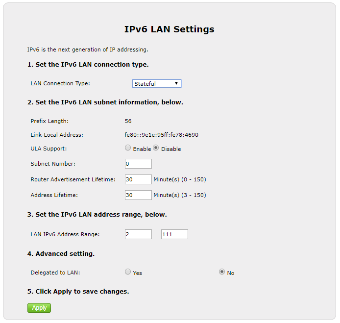

I have an option for Stateful IPv6, but I'm not sure what I would configure.

I can't answer that, as it would depend on your router, and DHCPv6 by itself might not be enough.
You should be aware that with IPv6, clients may join a network using SLAAC or Stateless or Stateful DHCPv6. Only the latter is about equivalent to DHCP for IPv4, in that it may actually force an IP address and several options on a client.
The former two calculate an IPv6 address for themselves while respecting a network's advertised prefix, and they may chose to accept additional parameters as offered by routers (DNS servers, time servers etc.).
However, with IPv6 a client decides autonomously how to integrate itself into a network, e.g. Windows devices prefer DHCPv6 and may support, SLAAC (starting with W10), while Androids exclusively support SLAAC.
