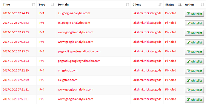

All I know is that when I attempt to edit a Google Blogger page it takes forever to load.
The query log shows:
