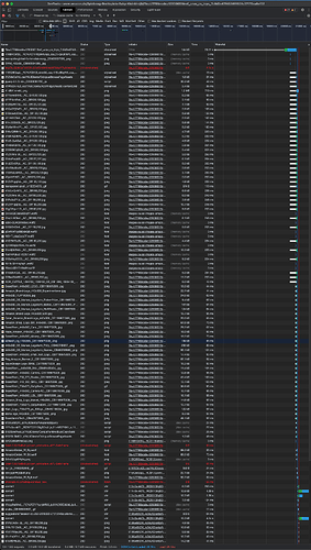

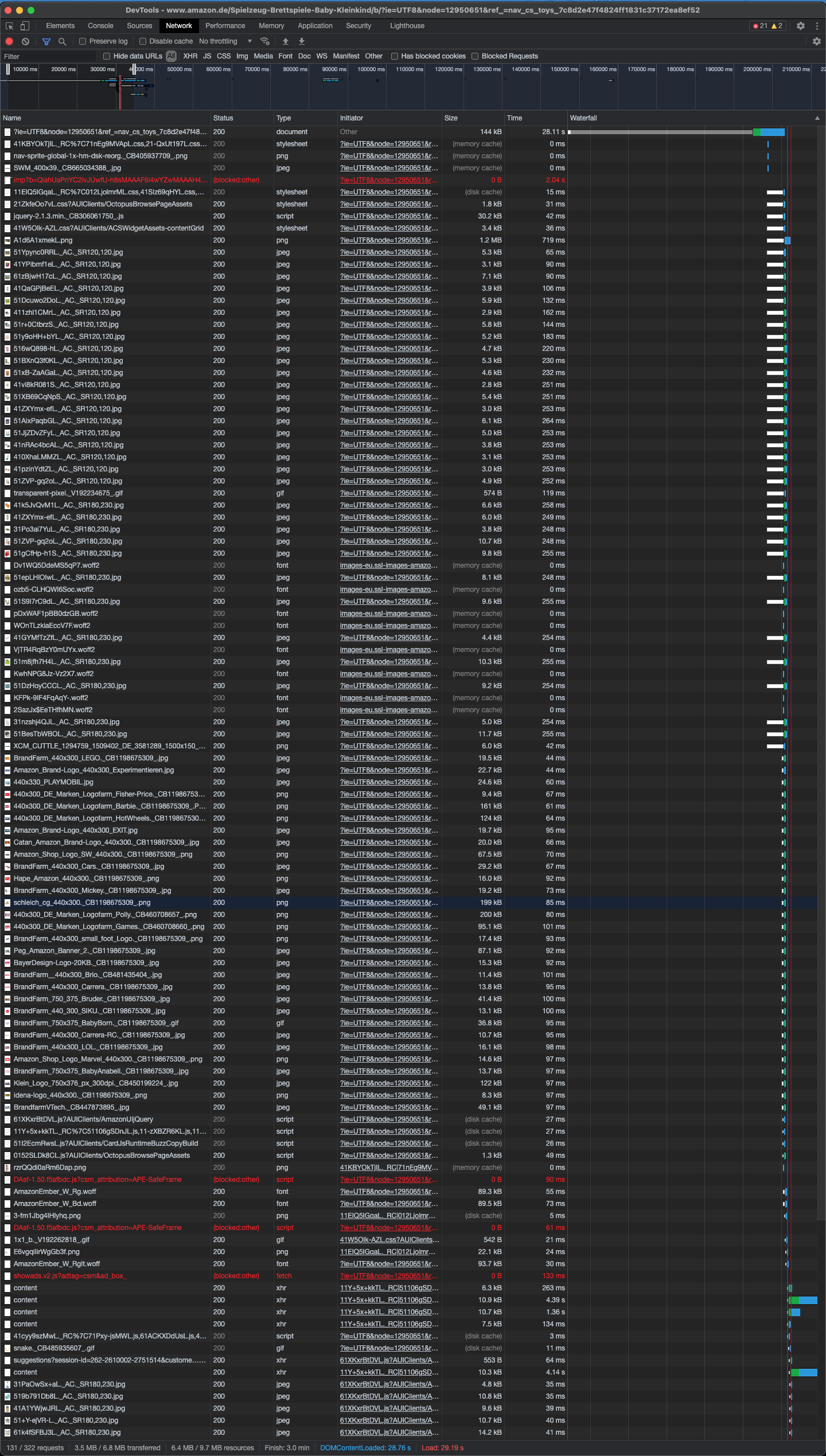

My problem is that browsing certain websites is extremely slow. It doesn't happen all the time, but frequently enough that it's noticeable. Sometimes it can take up to almost 30 seconds to load a web page. Things I tried to resolve the issue:
  • Disable IPv6
  • Using the iptables rules from here
  • Disable conditional forwarding
  • Change the IPV4_ADDRESS and IPV6_ADDRESS in the setupVars.conf to 0.0.0.0 / 0000:0000:0000(etc..)
I tried different browsers (Google, Brave, Firefox) and the results are similar. If I configure cloudflare DNS (1.1.1.1, 1.0.0.1) manually on my network interface I never experience the slowness. The ODROID C4 load is at the bare minimum so I doubt it is a resource issue. See below an example of loading a page from amazon.de where it took 29.19s to load the page:
