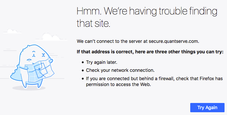

Just want to confirm that mine works as it should. Now that I use FTLDNS, what should I expect to see when I accessed http://secure.quantserve.com/quant.js and https://secure.quantserve.com/quant.js on my browser?
When I used dnsmasq, over http I can see a message the pi-hole blocked the domain but over https it will take some time and eventually timed out. Now using FTLDNS, on both HTTP and HTTPS I got the same result as per screenshot below. Is this what I should expect? Thanks for your help.
Certainly looks good to me - your screen shot indicates that pi-hole has correctly returned a NXDOMAIN response which is what you'd expect for a site in a blocklist.
Thanks for your confirmation @Packeteer
Yes, this is what you'd expect. Glad to hear that it works so well!
