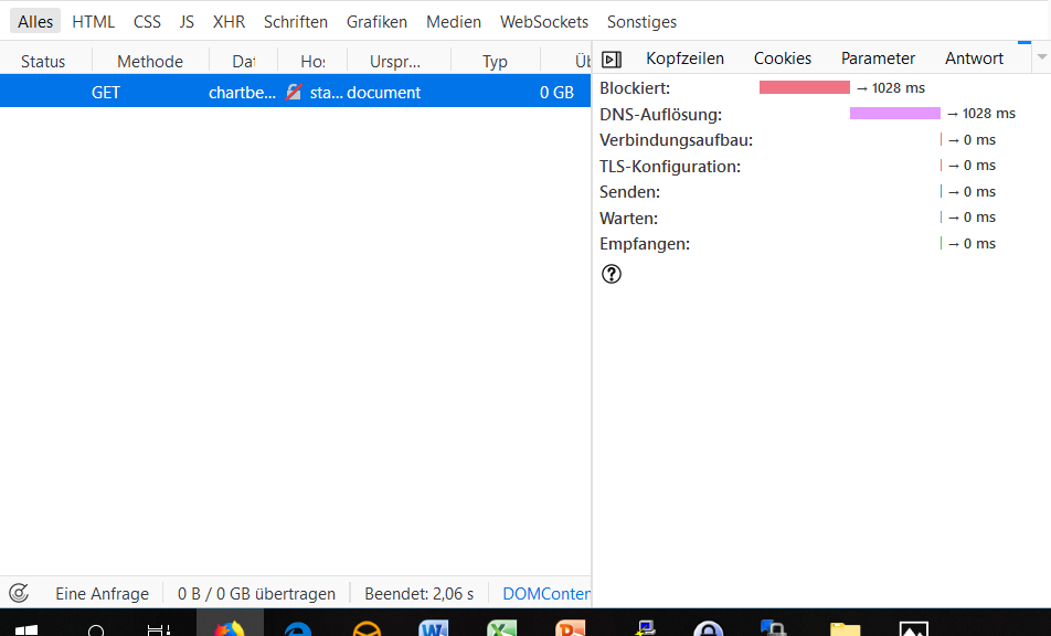

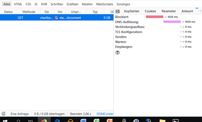

Open the dev tools and check the network request's timing tab. Take a screenshot of the timing. Is most of the time spent in DNS?
Thanks for your answer.
Please find a screenshot attached.
One second was caused by some local process blocking the request, and the other second was actually resolving the domain. Check the query log to see if it also says the query took one second.

Firefox measures 4000 ms for DNS blocked and again the exact same duration for DNS resolve. Consequently the overall time needed is 8 s.
I wonder that there is more than one dns request.
Thanks for your support!
Dnsmasq handled all of the queries within a second, so it is not slow at the resolver. Perhaps you have a network connectivity issue between your device and Pi-hole?
