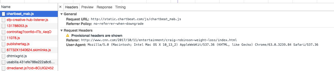

No response is sent at all and the request is failed. screenshot
Attempting to connect to a blocked domain via browser does not immediately resolve to the Pi-Hole, instead eventually returning a connection failed error.

If you open further details of one of the failed requests (try e.g. double-clicking one of the entries), does anything meaningful come up?

Thanks for responding. This is what I get when I click on one of the requests:
