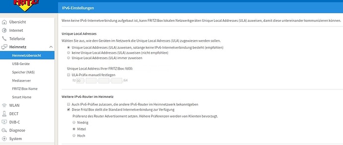

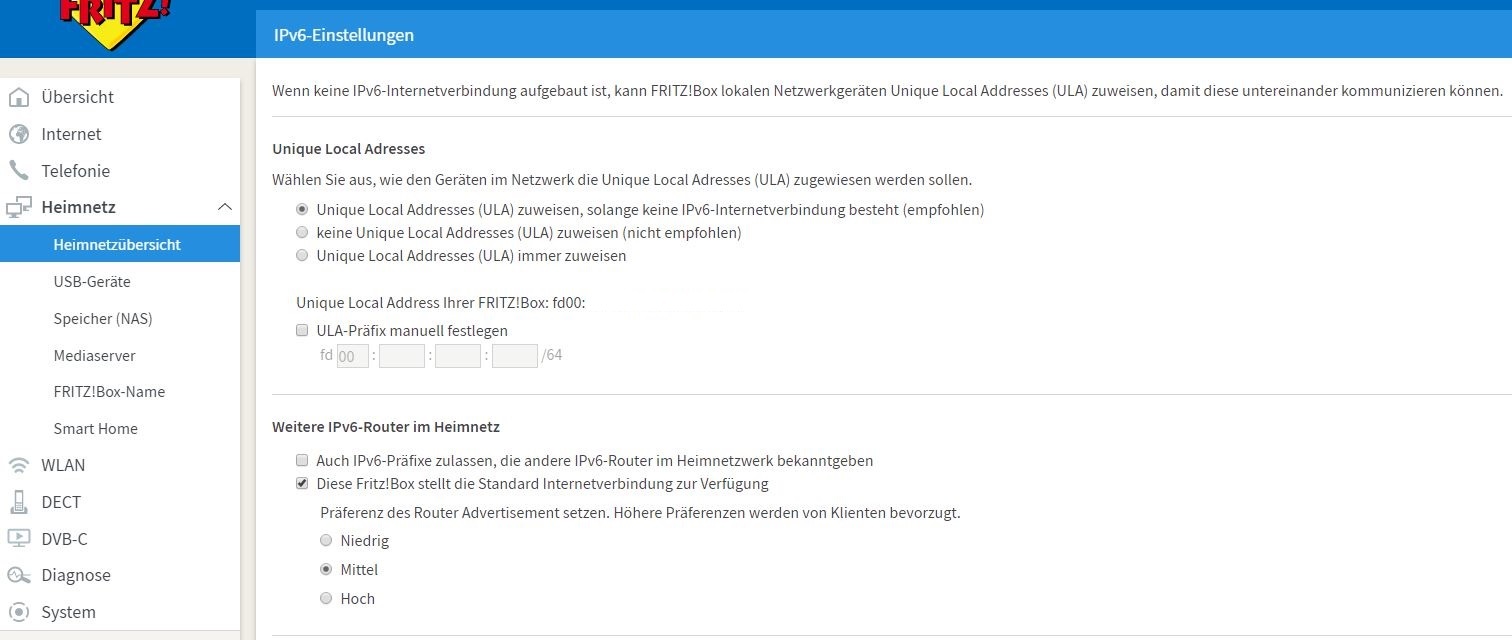

I believe this should be the Location for the Fritz!Box (one of the recent Patches). I assume setting it to the last Option will activate it. If I'm understanding that correctly, activating that setting will give every IPv6 cabable Device a ULA including Pi-Hole and we can circumvent the changing IP Adress?
I moved your thread from the FAQ page here, because you indicated that you want to discuss this first. We can later post to the FAQ itself, once we are sure how to deal with that.
I think so, too. I don't have a Fritzbox myself. So, please go ahead and try it out!
Good call, I've gone ahead and tried it, the Pihole got a ULA right after applying the Setting. I used your Code Snippets (altough I ran it with sudo -s because of the needed Permissions, otherwise it won't work on Raspian). Lastly I changed the Ipv6 DNS in my FB to the ULA.
Seems to work (at least for now) so this would be the Way for the Fritzbox I guess.
Okay, what is the model of your Fritzbox? I will add it on the FAQ page, if you have no objections - in the end it is your screenshot and you should agree before I modify (colorize) and use it :slight_smile:
Thanks for asking, you can add it, thats why I made it :slight_smile:
Sorry, I forgot to mention that, it's a Fritzbox Cable 6490 with Firmware 6.51
You should update to 6.80. :wink:
@DL6ER I'd like to add that this option is also available on my 7490 and probably all FRITZ!Boxes running FRITZ!OS >= 6.50. Unfortunately I can't find an exact changelog, however 6.50 includes the ULA setting and was the first version to allow setting a local DNS server without active Rebind Protection. This makes >= 6.50 a pretty good requirement to mention in the Wiki.
Thanks. I extended the text in the FAQ article.
Yes, you are indeed right, unfortunately it's a Rental Box configured via Provider. I'm waiting for the new Fritzbox Cable to be presented and arrive so I can switch :wink:

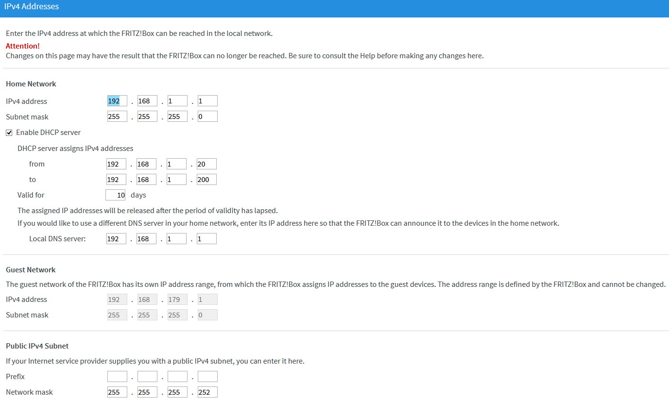

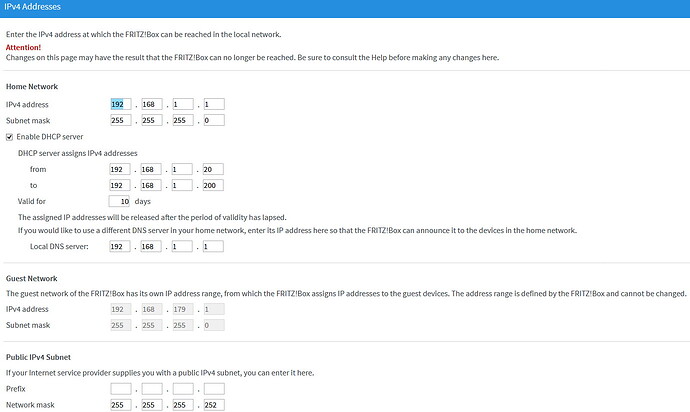

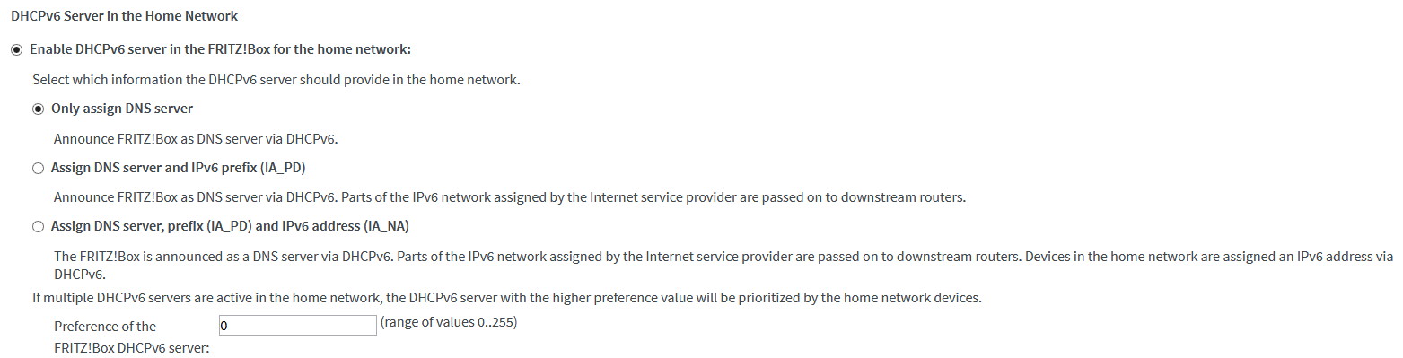

Here are some settings I have in my Fritzbox modem/router:
http://imgur.com/a/FfAsq (click to see more screenshots)

You could change two settings here:
  1. Specify the IPv4 address of your Pi-hole under Local DNS server rather than the Fritzbox itself
  2. Enable passing of the IPv6 prefix down to the network devices so they can do a proper selfconfiguration, i.e. try selecting the second (Assign DNS server and IPv6 prefix) instead of the first suboption
I did some tests and with only changing that first thing you mention it's working blazingly fast now!
Thanks for helping out!
