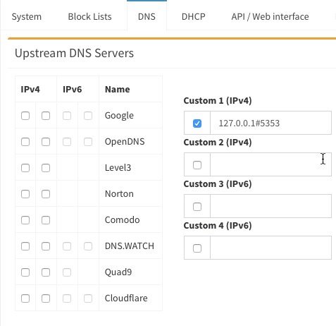

You are on the master branch of Pi-Hole, which does not support mapping to port 5353.
You can map to unbound on either the FTLDNS beta or on release 4.0 development. I recommend the latter.
echo release/v4.0 | sudo tee /etc/pihole/ftlbranch
pihole checkout core release/v4.0
pihole checkout web release/v4.0
After this is installed, set your DNS server to 127.0.0.1#5353 as shown below.
Let us know if this solves the problem.
It did not. I still got the connection time out error and when I assigned the dns server, my router disconnected from the internet. So thanks for your help everyone, but I'm gonna just use the regular pi-Hole setup and skip unbound for now.
