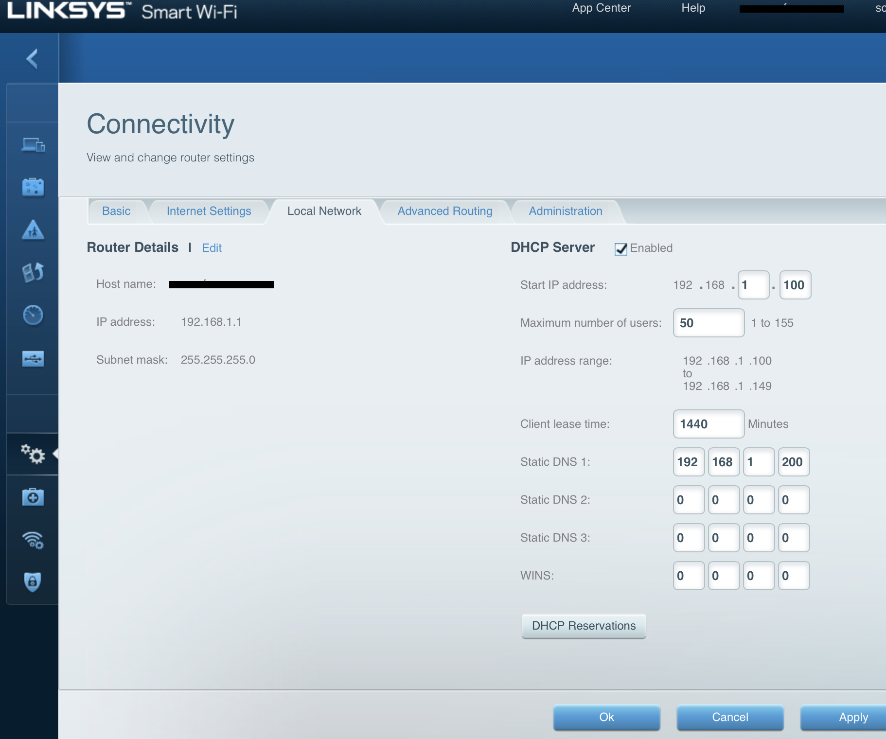

Trouble blacklisting and blocking ads
I having problems with wireless clients on my network still seeing ads. Ive set the DNS on my router to my Pi-hole’s iP address. It is the only DNS configured. My clients are set up to automatically configure DNS, which in turn is 192.168.1.1 the address of my router. The Pi-hole's IP is static. When I attempt view a webpage with ads, they are shown. If I black list a site like cnn.com, I can still access it. In the web admin page I do see some traffic being blocked, but not it does not appear to seeing all traffic for some reason. I must have overlooked something here, any suggestions?
Things I’ve tried
  • Pi Hole using wireless connection
  • Pi Hole using usb wired connection
  • Reboot clients
  • Renewed Lease on clients
  • Reboot Pi
  • Reboot Router
  • Clean install of Rasbian
  • Clean install of Pi Hole
  • Swapping to a different router
  • Using a different Pi
Hardware:
  • Pi Zero W running RASPBIAN Stretch With Desktop
  • Linksys EA6400
  • Wireless clients: iPad, iPhone, MacBook ProThis text will be hidden

Turn off DHCP on the router and use the Pi-hole for DHCP (or manually set clients to use Pi-hole). It looks like your router is either using more DNS servers than you specified (such as your ISP's servers), or is blocking the Pi-hole from working. Some routers have a setting called DNS Rebinding Protection, which in this case blocks local DNS servers from being used.
