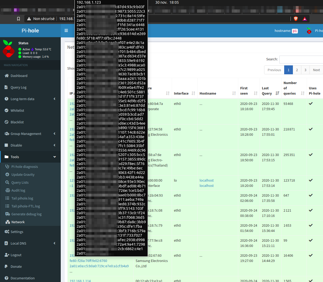

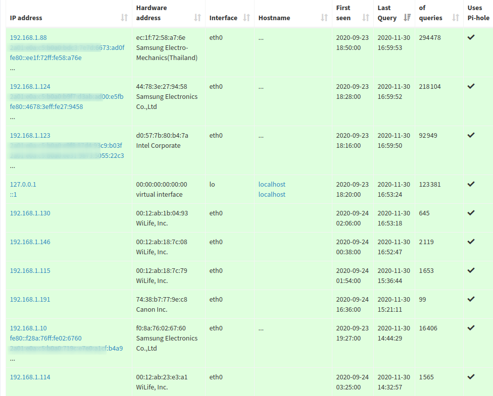

It looks like you have a LOT of IPv6 reverse looksup happening. Do you have a lot of clients listed on the Network tab/section of the admin interface?

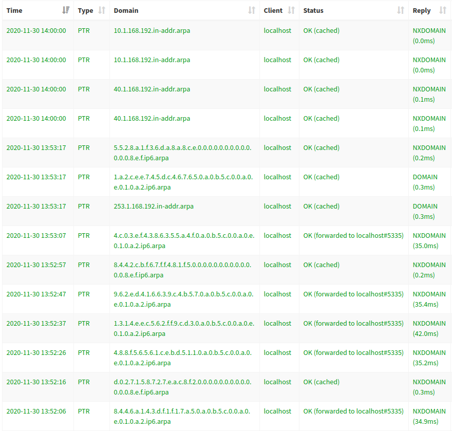

@DL6ER It looks like Pi-hole is answering IPv4 arpa from cache, but IPv6 arpa are being forwarded to upstream and coming back as NXDOMAIN. It doesn't appear that conditional forwarding is in use.
@vincent can you run pihole -d and post the URL token for us?
The common theme I'm seeing here is IPv6 globally unique addresses being used which is not a good practice for a LAN DNS server.
All the clients in the network page are well identified. But some of them get regularly new ipv6 addresses. I guess this is the normal behaviour of my router.

This looks like correct behavior. What Pi-hole does is exactly equivalent to
dig -x <IPv6-address>
If the local FTL instance doesn't know the answer it will ask upstream. With conditional forwarding, this can be limited to not doing so for subnets (works equally well for IPv4 and IPv6), however, the default behavior is to sent unknown PTRs upstream.

If there are IPv6 addresses that have queried Pi-hole and you want to know the hostname associated to that IPv6 address then I think this is what you are going to see. Pi-hole doesn't have any way to know if a host has changed it's IPv6 address after it used Pi-hole. I know the recent Apple iOS added security features that changes IPv6 addresses to prevent identification and this is preventing us from identifying the clients.
It's up to you to decide if you want to disable those features or disable IPv6 until you can find a setup that works for your particular needs. I personally don't see a need for global IPv6 addressing on a LAN segment but that viewpoint has caused a number of IPv6 fans to call me various names and slurs so I now leave that decision up to the user.

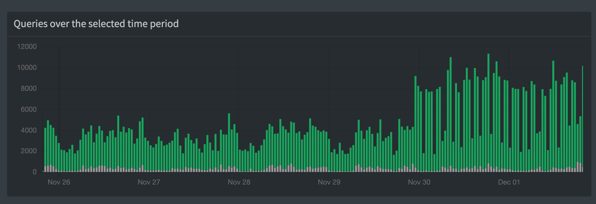

I am also seeing this behaviour since (and only since) updating to the latest release two days ago.
The graph below gives an indication of the changed behaviour:
The PTR requests from the Pi-hole that spike every hour are both on IPv4 as well as IPv6 - in fact the majority are for IPv4. Edit: Correction - while the majority are from the IPv4 localhost (127.0.0.1), they are primarily for IPv6 addresses. The fact that this only started after updating Pi-hole suggests to me that something is not quite right with the update. I don't accept that the solution is to turn off IPv6 - that is a bandaid at best.
The behaviour renders the query log graphs mostly useless as the Pi-hole PTR requests dwarf everything else. Worse, anecdotally there is degraded network performance when these spikes occur - presumably because the pi-hole gets overloaded with queries and therefore DNS resolution is affected.
It would be greatly appreciated if this could be looked into.
