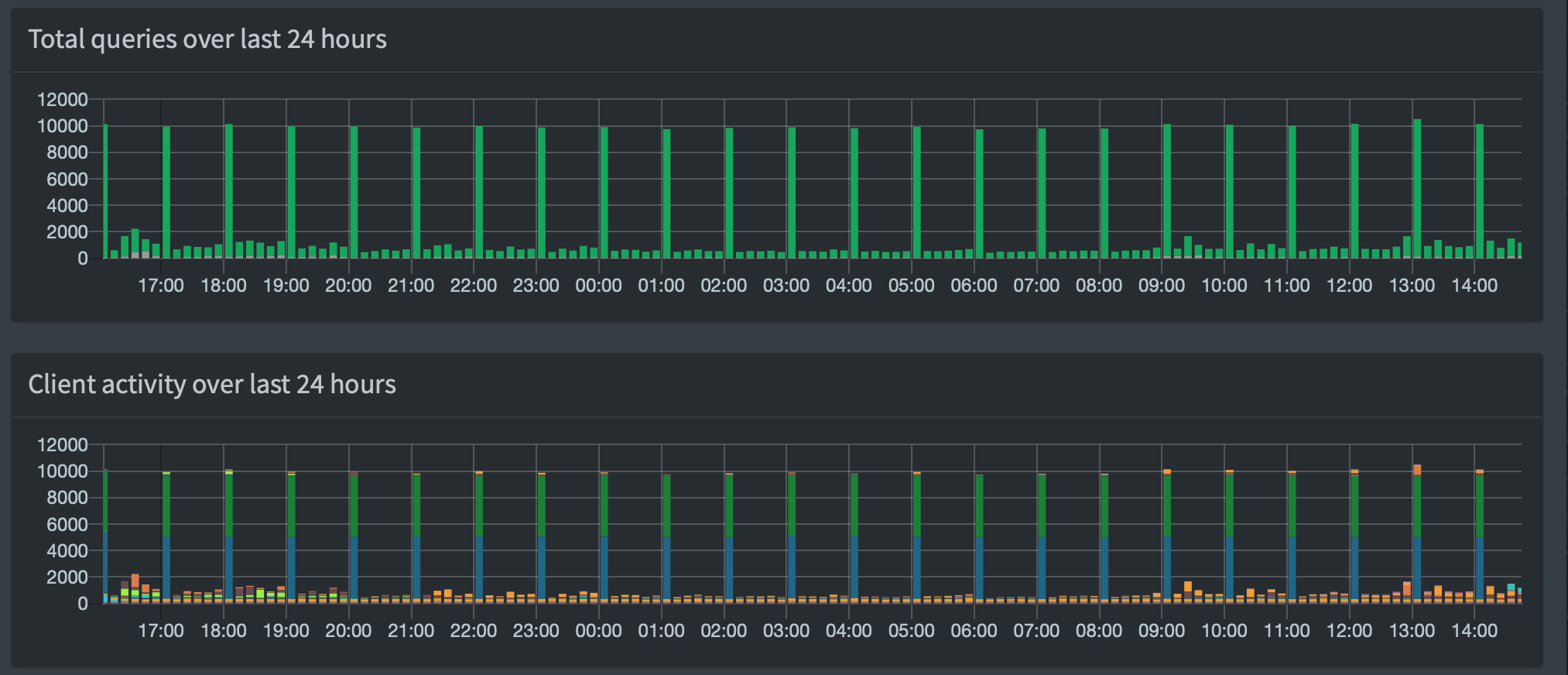

Pi-hole Reverse DNS queries every hour
The change is that with the most recent version, we also try to get host names for devices in your network which are not actively using Pi-hole. Assuming your devices made only (or at least mostly) queries over IPv4 to your Pi-hole, we haven't tried to resolve their IPv6 host names before.
We're already looking into this. The issue itself comes from the growing number of temporary IPv6 addresses being enabled by default in Windows and Mac (if I recall correctly). My proposed solution is to add a new option REFRESH_HOSTNAMES which which you can change how the hourly PTR requests are made. I'm currently thinking about three options:

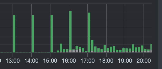

it seems to work:
These spikes up to 2200 queries are gone, there are 7 to 10 localhost queries now.

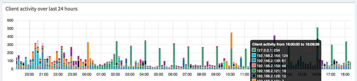

Hello!
I'm experiencing a similar problem since I updated my Pihole yesterday. After the update, I see exactly 234 PTR requests from 127.0.0.1 every hour. But these requests are IPV4. All these requests get answered from cache.
The dashboard says I have 19 clients. Network overview shows 14 green devices, 5 yellow, 43 light red and 10 red.
Before the update, I never had that many hourly requests. I can't explain where these requests come from, because my Pihole only knows 72 devices including the red and light-red ones.
Am I experiencing the same problem as described in ths thread?
I guess the "disable PTR for IPV6"-method will not work for me because my hourly requests are IPV4?
My debug-token is: https://tricorder.pi-hole.net/ju809xxgle

Same behavior here!
Screenshot about my previous post:
Last night at 2am I made the update. Now I get these spike with exactly 234 Requests from localhost every hour. (IPV4-Requests, no IPV6!)
Also, but this is just a small problem, my statistics are useless now when 234 requests gets answered from cache every hour...
