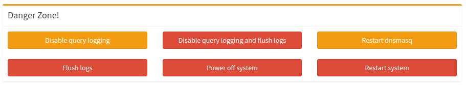

Disable Logging Without Flushing
We have also added a button to disable logging without flushing the log files.

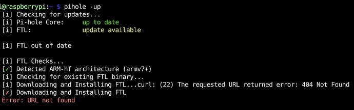

Getting 404 when pihole try to update FTL
Thanks, it should be fixed now.
