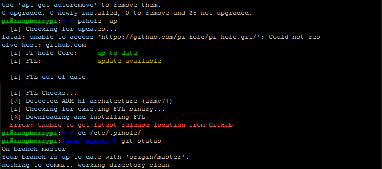

Error: Unable to get latest release location from GitHub
I keep getting this error, even after clean install.
What to do?

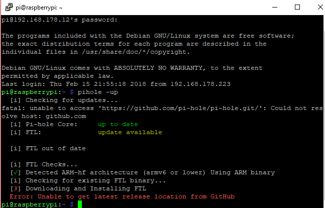

Hey I got the exact same error.
pihole -d stating the following:
" There was an error uploading your debug log.
    I already changed DNS settings to default (using router as DNS server) in my router and re-booted the pi - same picture as above.

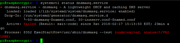

What's in /etc/resolv.conf and systemctl status dnsmasq?
● dnsmasq.service - dnsmasq - A lightweight DHCP and caching DNS server
   Loaded: loaded (/lib/systemd/system/dnsmasq.service; enabled)
  Drop-In: /run/systemd/generator/dnsmasq.service.d
           └─50-dnsmasq-$named.conf, 50-insserv.conf-$named.conf
   Active: failed (Result: exit-code) since Sa 2018-02-17 23:48:34 CET; 22min ago
  Process: 449 ExecStartPre=/usr/sbin/dnsmasq --test (code=exited, status=1/FAILURE)

Ahh yep. The version of dnsmasq in Jessie doesn't support the --extra flag in this release. We're working on a fix. You can revert to the previous version of Pi-hole for now. Not the most glamorous, but we're also looking at getting a later version of dnsmasq installed but it's still in the works.

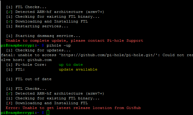

I have the same question; my issue was exactly the same as described above. Pihole just wouldn't work and my Pi was not resolving DNS queries. I reverted to the 3.21 Version a described above (very slick Jacob) and it now works, but I have two questions now:
  1. How do I know when the dnsmasq issue is resolved
    2, How do I get the Pihole system back to where it is current and checking for updates?
Please keep in mind I am a complete noob when it comes to this. COMPLETE. Please take a look at the attached screenshot from the Web UI. I hate to admit it, but I am one of those folks that need the step by step. Thank you all for your help!
For Continuity Purposes, here are some of the error messages I received before reverting .
