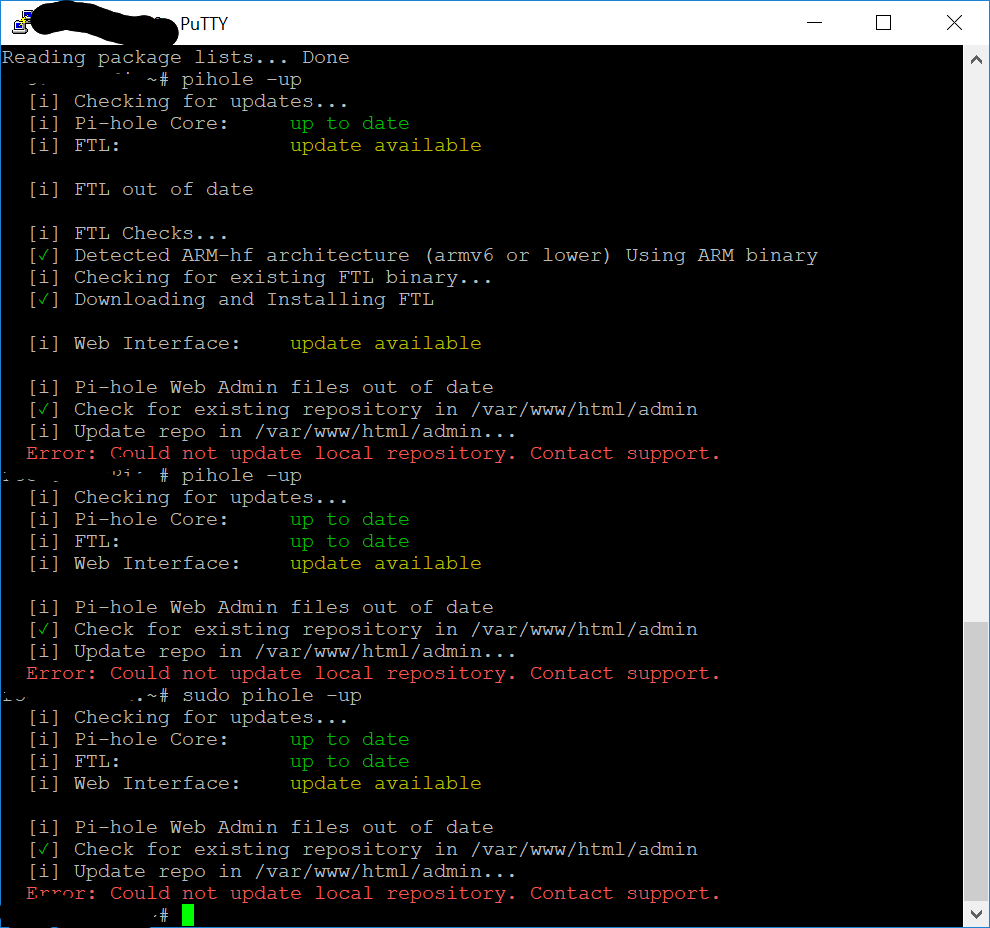

However when i try to update my pihole to the latest version i get an error and im hoping you guys can fix it.
Im using dietpi as a host os, not sure if thats usefull info or not.
See below for the error message:
https://imgur.com/GeteqY2

You have some changes in the web directory. Try these commands then update:
cd /var/www/html/admin
git reset --hard HEAD
What was the full output of the update command? Also, what is the output of this command? sudo service lighttpd status
this fixed the issue.
