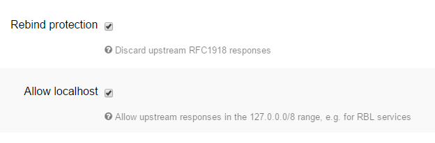

OpenWRT
You can disable it in /etc/config/dhcp by setting this to 0:
option rebind_protection 0

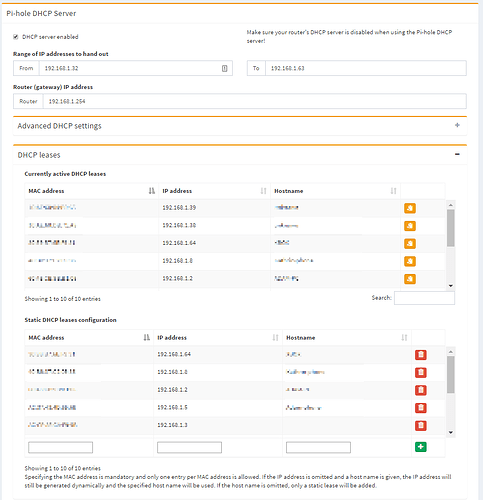

Pi-hole now ships with a built in DHCP server. You can disable DHCP on your router and use Pi-hole to handle DHCP (and DNS).
