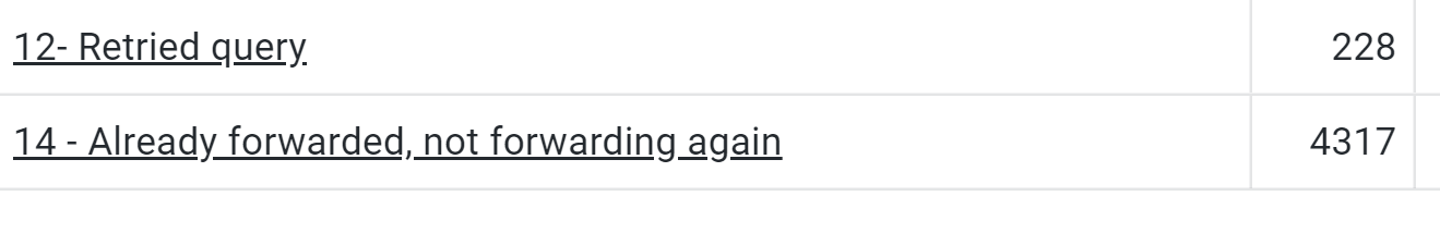

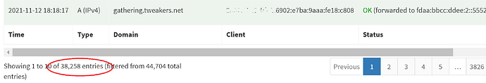

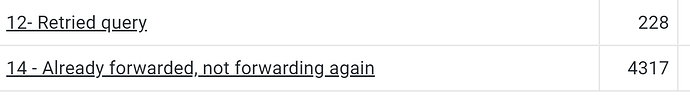

The result is that all queries received by unbound are forwarded to pihole-FTL, most of the queries (all IPv6 queries) in the query log appeared to be comming from pi.hole (normally, that count is close to zero).
It also increases the number of status 14 (Already forwarded, not forwarding again) dramatically.

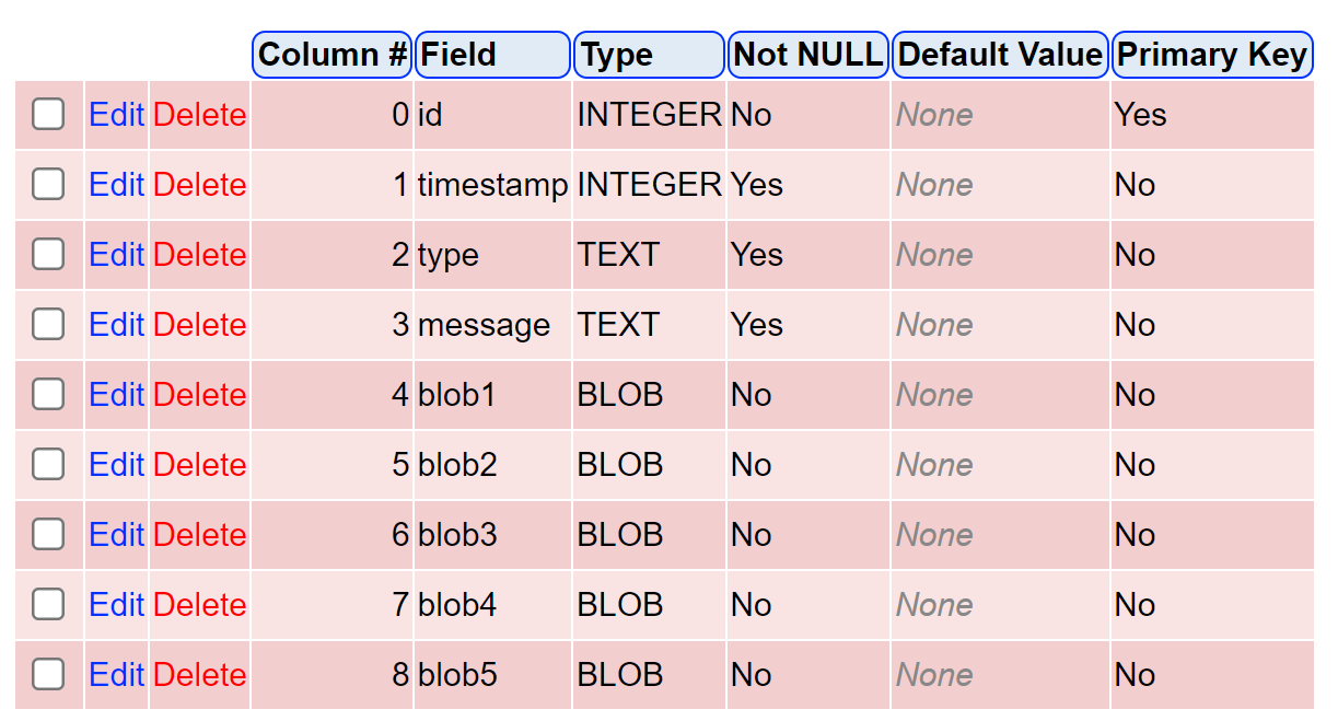

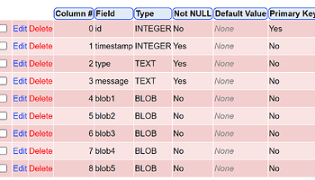

This is the structure of a message:
What I want to know is what to put in the differenf fields, so the message will appear in the web interface the way you intended. e.g. something like:
assume (example) these entries in the log:
[2021-11-14 09:00:01.865 875/T881] SQLite3 message: database is locked in "SELECT name FROM network_addresses WHERE name IS NOT NULL AND ip = ?;" (5)
[2021-11-14 09:00:01.865 875/T881] getNameFromIP("xxxx:yyyy:zzzz:6903:e9c9:580a:faff:143a") - SQL error prepare: database is locked
sudo sqlite3 "/etc/pihole/pihole-FTL.db" ".timeout = 50000" \
"insert or ignore into 'message' \
( timestamp, type, message, blob1, blob2, blob3, blob4, blob5 ) \
values ( \"${timestamp}\", ....);
what are the intended values of:
  • type (?)
  • message (?)
  • blob1 (?)
  • blob2 (?)
  • blob3 (?)
  • blob4 (?)
  • blob5 (?)
additionally, there is no UNIQUE field, which makes it hard not to flood the message table.
Depends on the type
Probably even more obvious if you look at how the web interface interprets the values:
https://github.com/pi-hole/AdminLTE/blob/ee50954be76fa53bdc4d95a3dd197030b96af5ab/scripts/pi-hole/js/messages.js#L28-L89
Yes, because the various fields may have different interpretations and the same message can be meaningful multiple time (e.g. the same error in multiple regex).
FTL ensure itself that no duplicates exist for types where this is meaningful (like rate limiting or hostname error messages)
