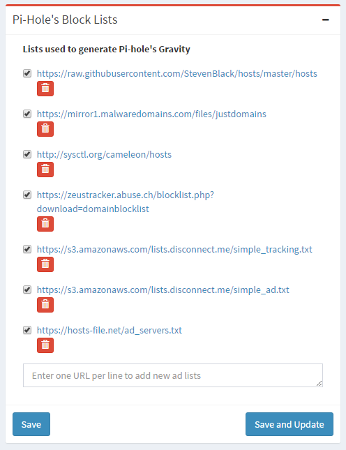

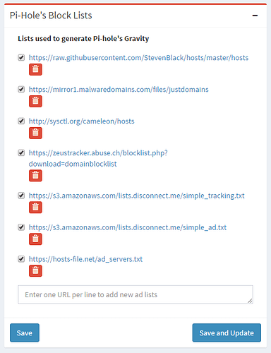

UPDATE: As of version 3.0, adlist management can now be done via the web UI, you no longer need to touch the command line for this!
By default, when pihole -g pulls in lists of domains to block, we combine several lists, which are defined in /etc/pihole/adlists.list:
