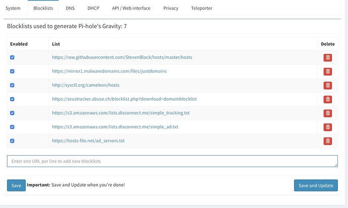

How does one actually add the lists to Pi-hole? I see oodles of links for lists but how are they added?
From the Web admin GUI > settings > blocklists. Enter one (or more in the same block if separated by line breaks) URL for a public blocklist in the box near the bottom, then after you have entered the last one, click on "save and update" and gravity will be rebuilt to include your new lists.
Great! Thank you very much. I guess I might have eventually found it.

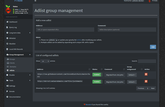

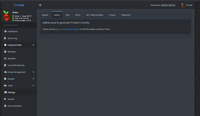

Where is that GUI screen in the interface mentioned in the update? "As of v 3.0 .. Pi-Hole's Block Lists"??? Seeing a screenshot doesn't tell you where to navigate to find the checklist!!
Whelp, we need to update this page again. , Settings -> adlists:
http://pi.hole/admin/settings.php?tab=adlists
But, that now links to the new page, here:
http://pi.hole/admin/groups-adlists.php
Thanks for the immediate quick response!
