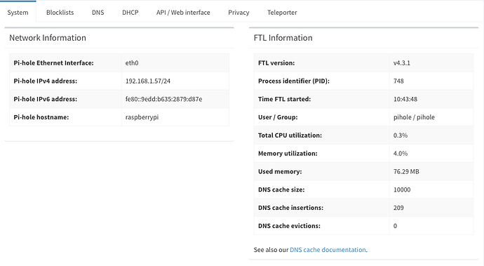

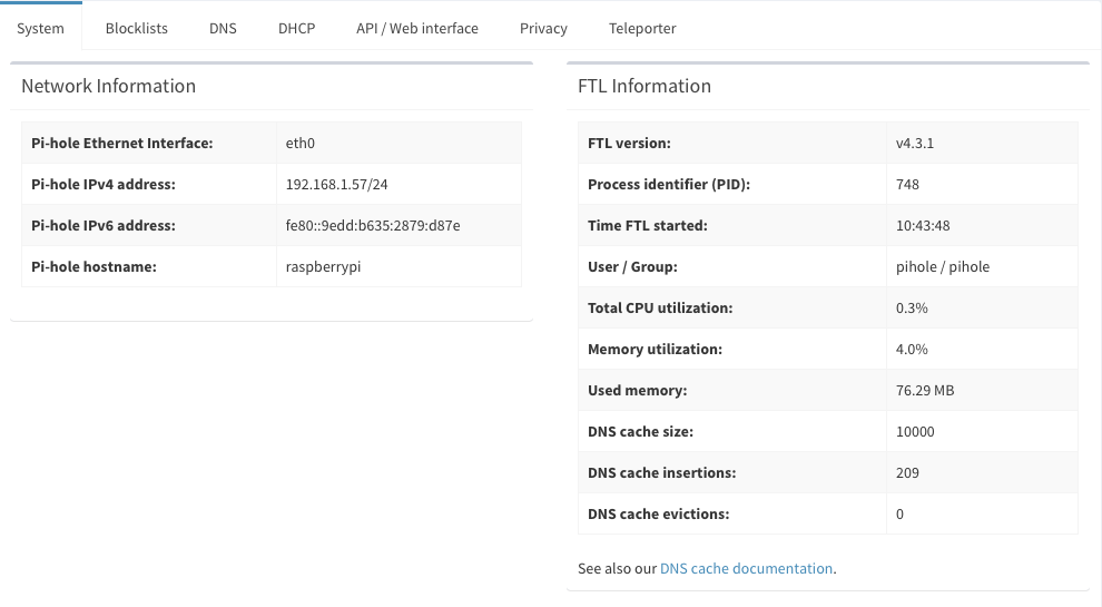

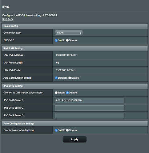

What you describe here doesn't match your screenshots:
They show you've set your router's upstream IPv6-DNS to Pi-hole's IPv6 address (if only a link-local fe80: - first screenshot), and that you have configured your router's DHCP to hand out Pi-hole's IPv4 address (192.168.1.57) as local DNS server (second screenshot).
Yet you claim your clients still show your router (192.168.1.1) as DNS-Server.
This could be the case if
  1. your router includes itself as local DNS via DHCP, no matter what.
    (There are ASUS router models known here on this forum that exhibit this behaviour)
  2. your router does not force renewal of ist DHCP leases upon configuration change, and thus the new settings will be known by your clients only after their current lease expires
    (Default lease duration varies by router make and model, common values range anywhere from one to ten days.)
Depending on your clients, they might connect by IPv4, contact your router, which forwards rqeuests to its upstream IPv4 DNS (no screenshot for this, so assuming: goes to ISP default DNS).

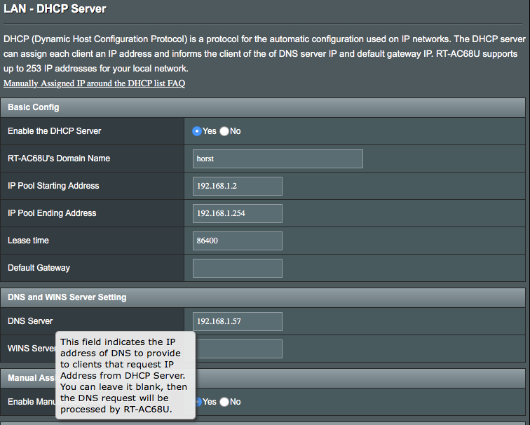

Thank you @Bucking_Horn, I'm trying my best to get to grips with the functions and terminology :woozy_face:
This has now been disabled altogether. I'm not sure at all if and what this page is for (apart from being IPv6 related).
That is correct. Isn't this the way it should be? If not, what am I mistaking here?
The clients don't report any change of the DNS address, when I renew their DHCP lease manually.
Looking at the LAN-DHCP Server page, I see no other option than to enter the Pi-IP under DNS and WINS Server Setting > DNS Server … do you?

As far as I understand it, by default, local clients apply whatever is the default local DNS address broadcasted by the router's DHCP server. Unless local clients were configured to use a specific DNS address. Right/wrong? :thinking:
My local DHCP server at home is the Asus router, to which the Raspi running Pi-Hole is connected via eth0.
My current theory is:

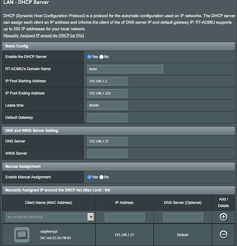

The IP address of Pi-Hole should be set as DNS server address, which the DHCP server of the router broadcasts to all clients of my local network. According to this, all local client DNS calls run through Pi-Hole. Right/wrong? :thinking:

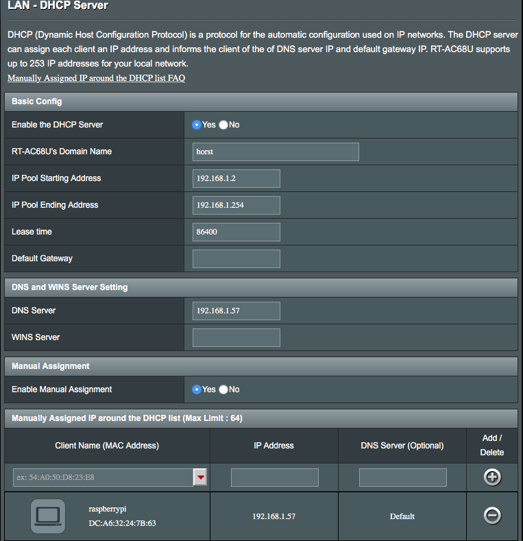

This screenshot shows where, according to my understanding, the Pi-Hole address should be entered.
Question:
Is it possible to configure the router DHCP server, so it is broadcasting the Pi-Hole IP address as the local DNS server address? Is this the ideal configuration?
Almost right - my overly pedantic additions and removals to your remarks as follows :wink:
As of your last screenshot, it looks as if your DHCP settings on your router are set up to distribute Pi-hole as DNS server. This would also be the preferred way, as this will allow you to view individual clients in Pi-hole's Query Log (which would not have been possible when keeping your router as DNS and forwarding requests upstream to Pi-hole).
My previous remark on possible impact of lease duration still applies.

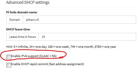

EDIT: Actually, I wonder if this would still be necessary if you run Pi-hole as DHCP, but I am unaware of an option to configure a ULA via Pi-hole's UI - calling in @jfb, @deHakkelaar already reads and will comment if he knows)
Alternatively, do not enable IPv6 support in Pi-hole's DHCP and get rid of the IPV6_ADDRESS entry in setupVars.conf. Note that this might encourage some IPv6 capable devices to look for an IPv6 DNS server elsewhere, and some of them might succeed, thus bypassing Pi-hole. But then again, they might just as well do that if IPv6 is enabled. Happens more often than I'd wish for - darn! IPv6 auto configuration :wink:

Enabling IPv6 support (SLAAC + RA) didn't change the Network debug output tho … should this be active?
(see https://tricorder.pi-hole.net/ke06y31kjx for that)
