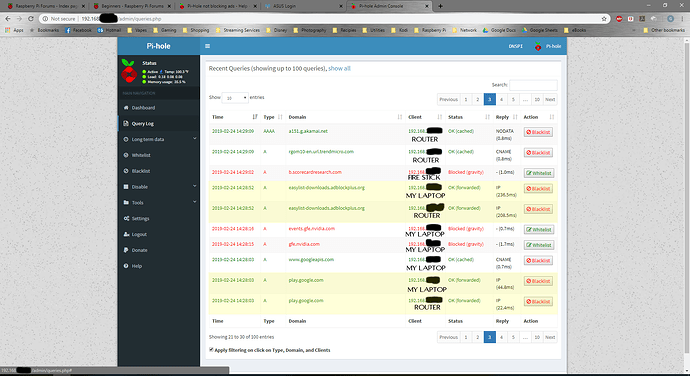

For my logs, I'm going to try and attach a screenshot to show how I see requests that come from both the router and client at the exact same time. The top-most router entry (akamai) was also called from my laptop, but that entry was on page 2.
So 2329 lookups from the laptop addressing Pi-hole directly are accounted for.
The other lookups the laptop does against the router IP are obscured in the other 2317 lookups from the router where you dont know where coming from.

ns lookup:
Default Server: raspberrypi
Address: 192.168.1.252
