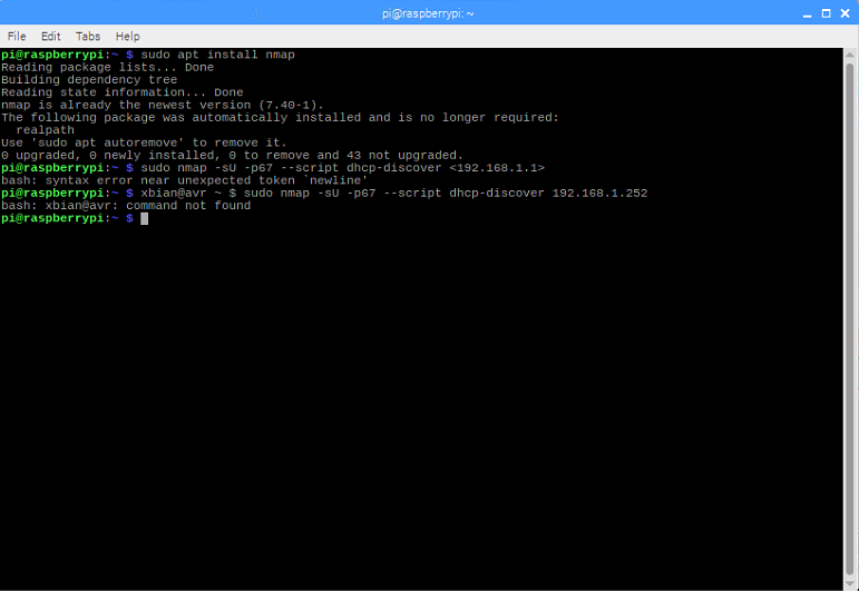

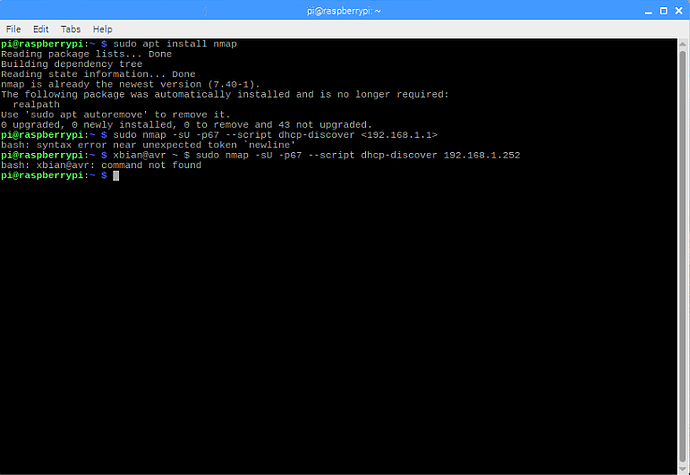

I have entered it like:
<192.168.1.252>
<ASUS_ROUTER_IP_ADDRESS>
<ASUS_ROUTER_192.168.1.252>
<192.168.1.1>
<ASUS_ROUTER_192.168.1.1>
I have disabled the DCHP on the router, doesn't work.
Example with 10.0.0.2 doing DHCP on my network:
xbian@avr ~ $ sudo nmap -sU -p67 --script dhcp-discover 10.0.0.2

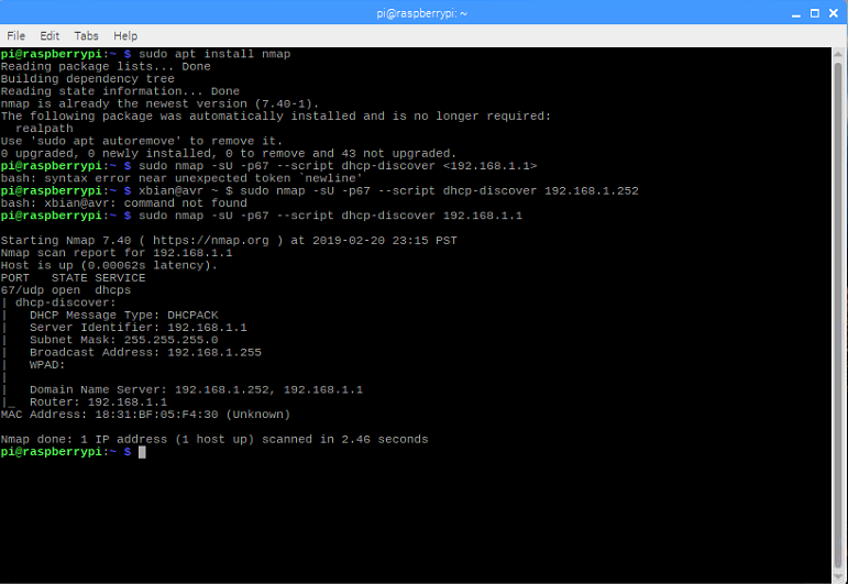

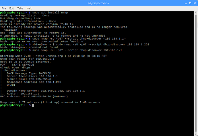

Am I even doing this right?
Is 192.168.1.1 your Asus router ?
If so, try below:
sudo nmap -sU -p67 --script dhcp-discover 192.168.1.1
It worked!
Basically I have two DNS's. I don't remember putting my router ip as my dns in either the pi or the router.
If a client gets two or more DNS servers assigned that are not Pi-holed, you can imagine this breaking the ad blocking when the clients query the other DNS occasionally.

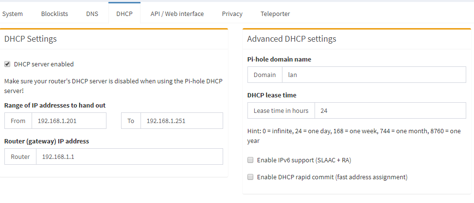

Me and the user from the other thread were not able to get ride of that second DNS IP coming from the Asus router.
Thats why we disabled the DHCP service on the router and activated Pi-hole's own DHCP service as a replacement:
EDIT: Dont forget to renew DHCP leases on the clients when switching DHCP!
Leases get renewed when disconnecting and reconnecting clients from network or reboot them.
Might also want to clear browser cache and if know how, clear OS DNS cache too.

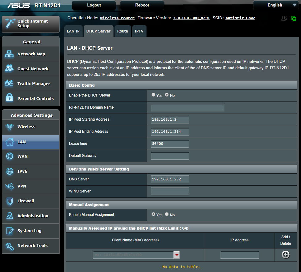

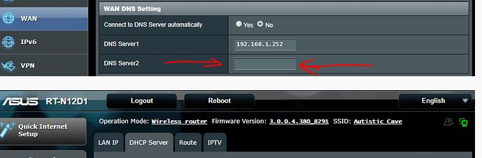

Did you try having 192.168.1.252 in both "preferred" as well as "alternative" dns server fields?
My Asus firmware only allows to enter one external DNS server.
So thats no go.
Are you sure? This was taken from the above:
Thats the WAN part of the router.

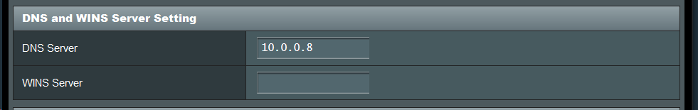

The DHCP part, the one handing out the DNS servers to the clients, only has one DNS field:
I did change it later
