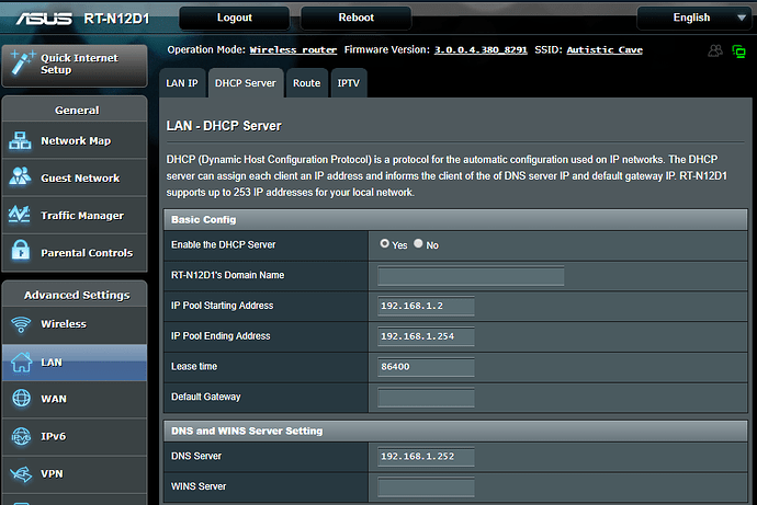

I have changed the dns number to the pi-hole under the the LAN tab,DHCP server under DNS and WINS server setting.

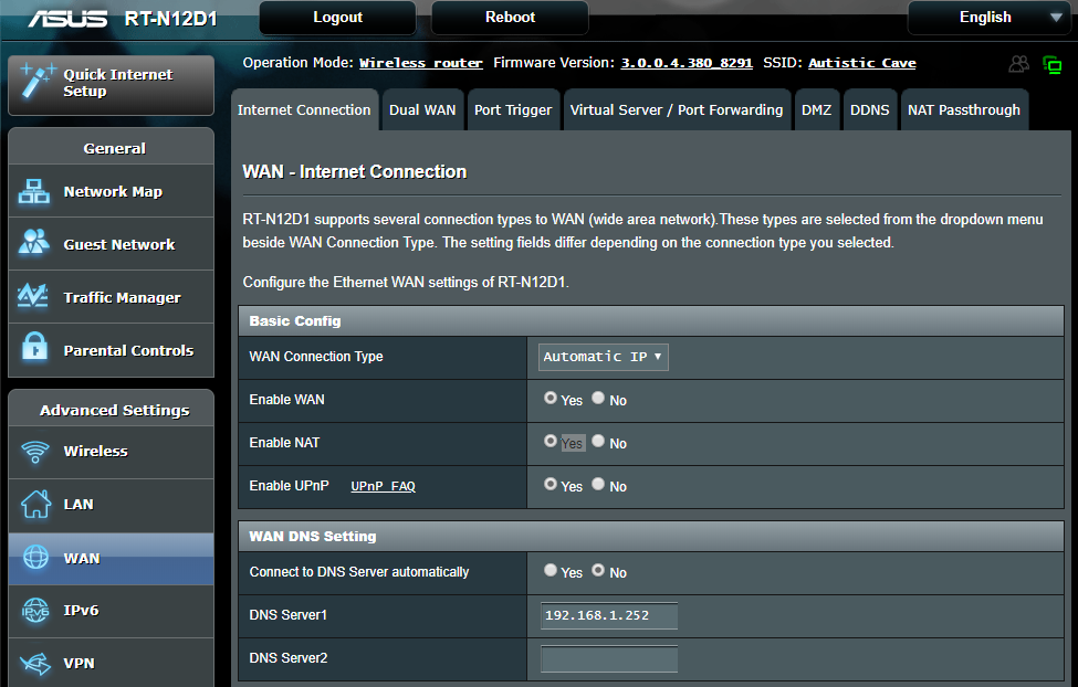

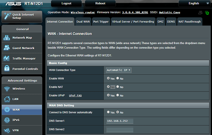

I have also changed the dns server under the WAN tab, DNS settings and changed those numbers.

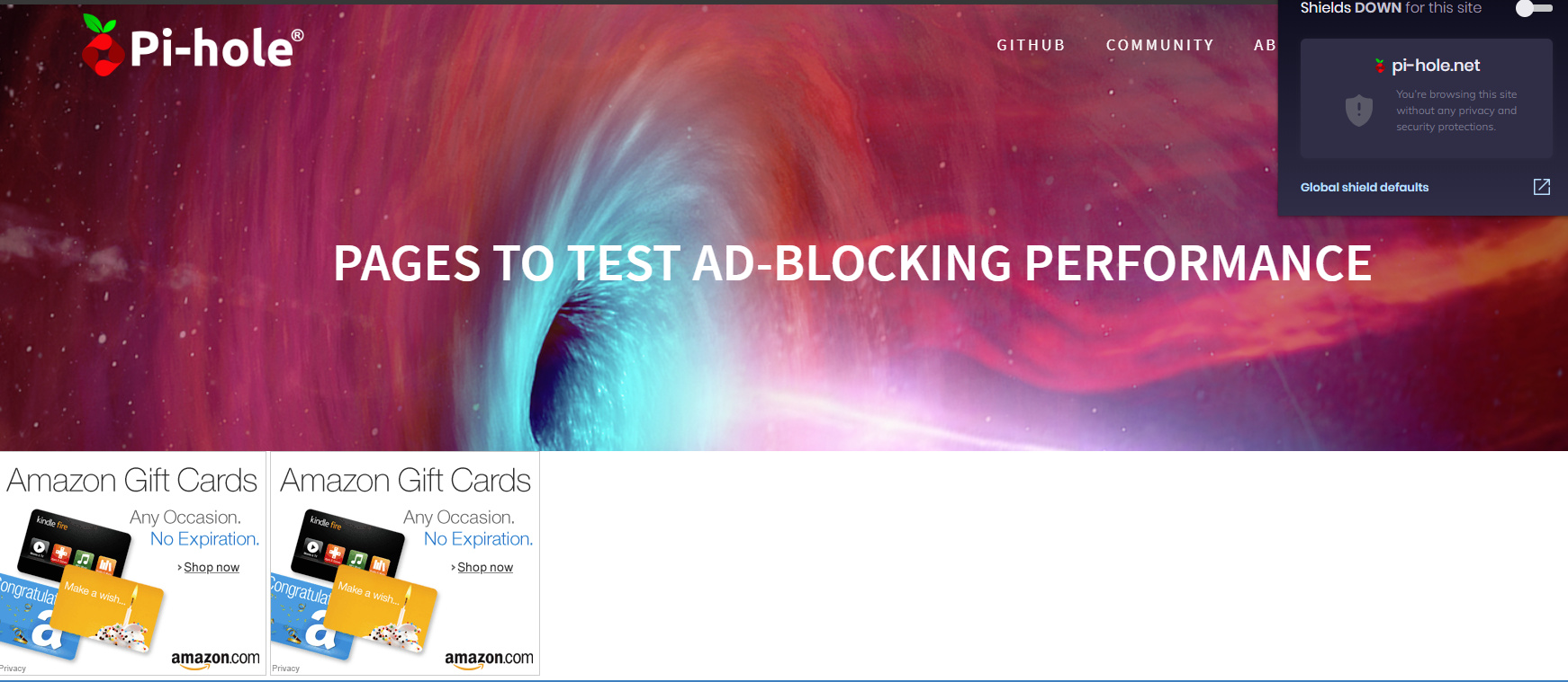

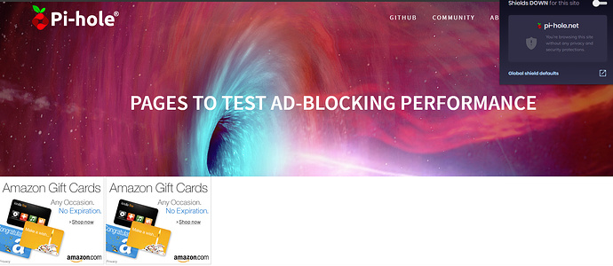

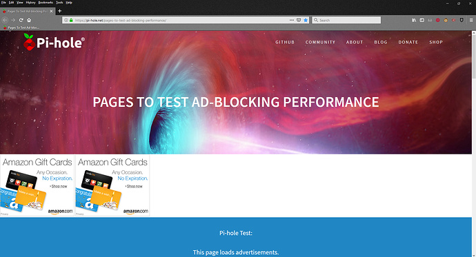

I go pi-hole's test page and it's still showing those two ads.

On the pi itself is blocking ads on the ad block test page provided by the pi-hole site. On all other devices, it does not block those ads. Ad is rcm-na.amazon-adsystem.com. I would like to know how I can block this ad without the brave browser's blockers.

I have made changed to DNS numbers on my router in a couple of places.
