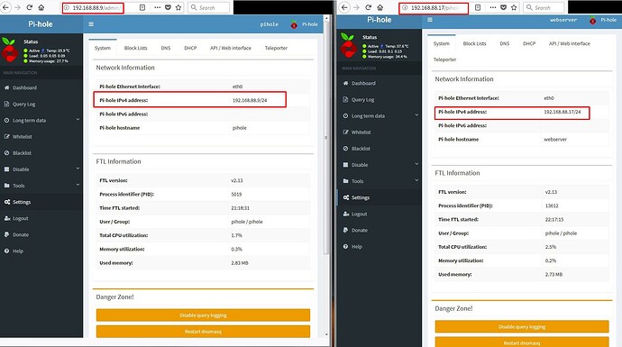

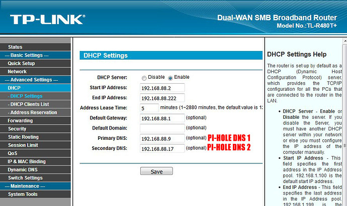

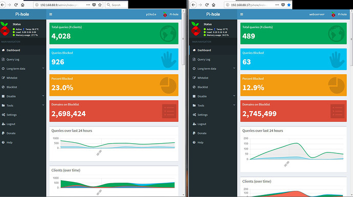

I have tried but unfortunately not working as expected
What is not working as expected? I see in both of your Pi-holes that there are queries, although they are not equally distributed. For what do you use the WAN DENY rules?
Very crude but I wouldnt call it load balancing :smiley:
Nice effort though!

  1. not equally distributed.(round robin for example)
  2. WAN DENY rules for google DNS servers (4 experiment)
