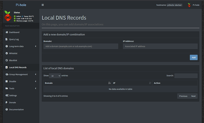

Admin Edit:
This Guide is now outdated, you can make use of the built in "Local DNS Records" feature on the web admin panel

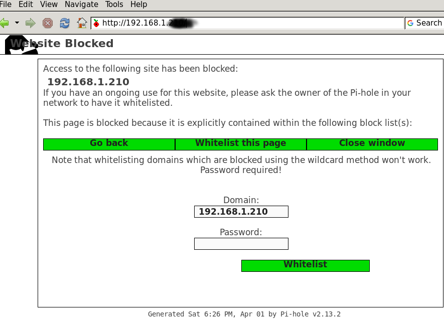

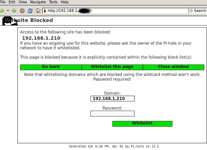

Hello
it worked very well, thanks
I set the DNS server in the router config and all are properly resolved.
I have only one problem, the web admin pihole is blocked, he stops himself :grin:
I tried to withelist the domain of my house but nothing.
Some screen:
What domain are you using to access the web interface? By default you can only use pi.hole, localhost, or the IP address.
Hi, thanks for your tips but i have tried everything from the inside of machine itself and from outside (ip, fqdn etc).
The same from inside of machine whit ip, localhost, 127.0.0.1 etc:
EDIT: with "pi.hole" from inside of machine i did it! ty :slight_smile:
now i only have to understand how to have access from outside the pihole machine.
You have been mislead by the fact that the blocking page will also be shown for everything that would receive an error 404 (Not Found).
In your case, the resource you have been looking for does not exist. Note that you have to go to
192.168.1.XXX/admin
Not
192.168.1.XXX
yes, right. I can access to the admin page.
Many thanks and sorry for bothering you
No worries! We are glad if we can help :slight_smile:
