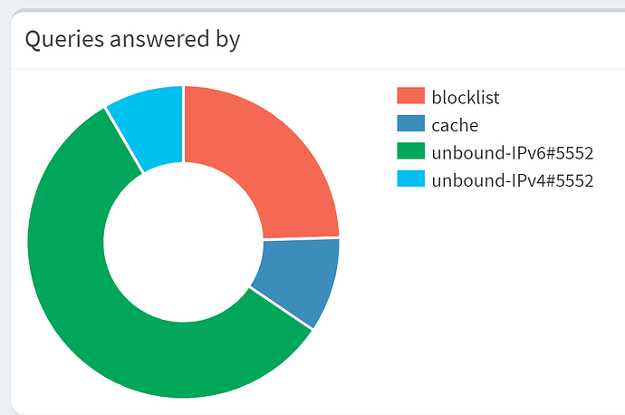

I do assign static IPv6 addresses on my pi, using the above described method (/etc/dhcpcd.exit-hook)
I use this to identify the different resolvers pihole-FTL is forwarding DNS requests to.

Why? for this result in the dashboard:

For inter-communication between Pi-hole and a co-located unbound, one address does suffice. There is nothing to be gained by supplying an IPv6 in addition to an IPv4 address, or vice versa.
I'd drop the respective other, which in your case would have me prefer IPv4 since that already simply works, as you put it. :wink:
