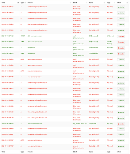

This is fantastic, really. I did update again and both Pi-holes are working beautifully now. I have my FTLDNS configuration set up to do reverse IPv4 and IPv6 lookups against dnsmasq on my OpenWrt box. Because I also run ip6neigh on my OpenWrt box, I have IPv6 SLAAC reverse lookups working there.
So with the updates you just made for EDNS0 processing, I am getting my ipsets populated on OpenWrt for QoS purposes, client IP/hostname reporting against queries in my Pi-hole VMs, and the piece of mind of having my Pi-holes querying externally via dnscrypt-proxy. I'm a happy camper with a big smile on my face right now. :slight_smile:
View of Pi-hole web console:
(Look at all that samsung tracking getting blocked... :clap:)
I will obviously be using the heck out of this, so I will be sure to report back on any hiccups. Although I have a good feeling this will be a continued success!
