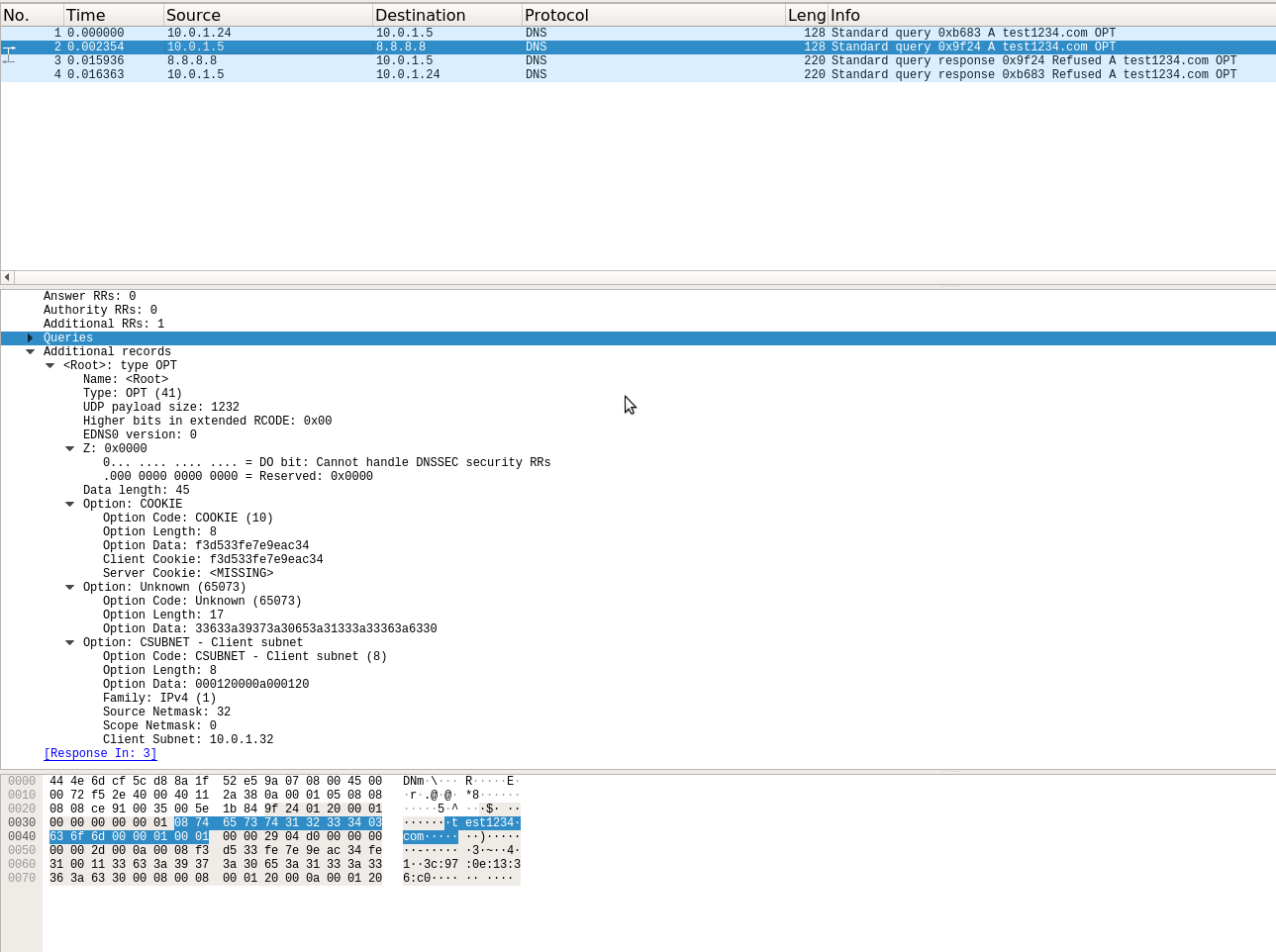

I have dnsdist setup between Pi-hole and my clients. I use ECS Client Subnet as described in this topic to still have Pi-hole display the clients accurately.
Recently I've decided to change from using Cloudflare's DNS to Google's. I was surprised once making this change to find all of my queries were being rejected. Upon investigation I discovered that Pi-hole was sending the ECS subnet information from dnsdist to Google's DNS server. This post makes me think that this is not intended behavior. Google's DNS server is rejecting the queries with the following error: Provided ECS includes 32 bits, but no more than 24 are allowed. https://developers.google.com/speed/public-dns/docs/ecs.
I have tried to remove the ECS information from Pi-hole's forwarded requests by adding add-subnet=0,0 to the dnsmasq config, however that does not help. For my use-case, the subnet information should only be sent from dnsdist to Pi-hole.

Unfortunately when I run pihole checkout ftl tweak/strip_EDNS0_ECS it returns pihole checkout ftl tweak/strip_EDNS0_ECS. Looking into it, it looks like a test is failing.
Ah, yes. The failing test prevents the upload of the binary as the CI assumes the generated FTL binary is broken. It seems verteiltesysteme.net is not available right now. Their entire infrastructure (134.91.78.139, 134.91.78.141, 2001:638:501:8efc::139, 2001:638:501:8efc::141) seems to be down.

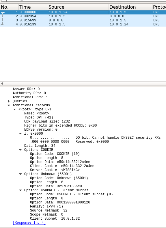

Before

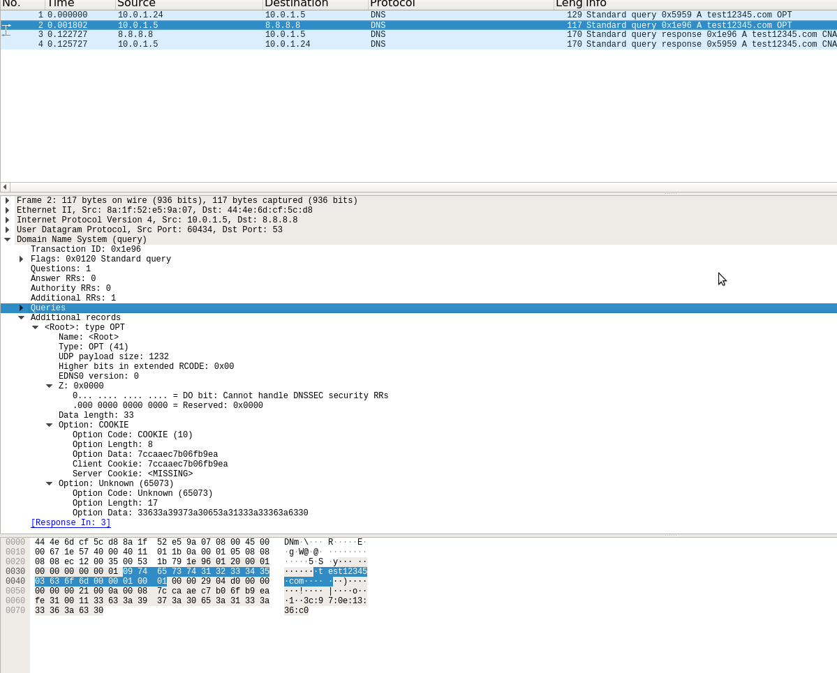

After stripping

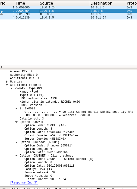

Furthermore, I refined how the options strip-subnet and strip-mac work: You can now specify them together with the corresponding add-... options to achieve a replacement of the data. Note that this isn't currently possible in dnsmasq as add-subnet and add-mac only did something when no such information was present in the incoming query.

Also this is working as expected. I tried both, stripping and replacing.
Example replacing both, subnet and MAC

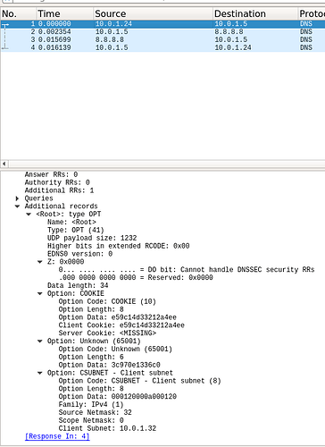

Original query:

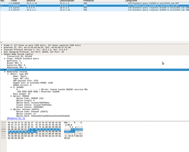

Replaced subnet and MAC
