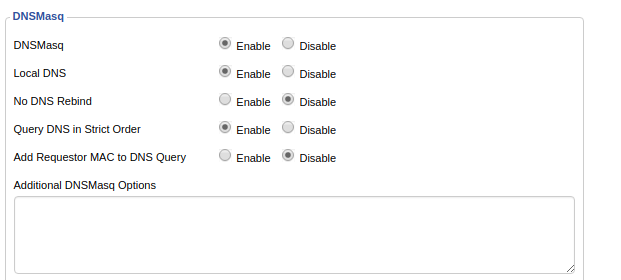

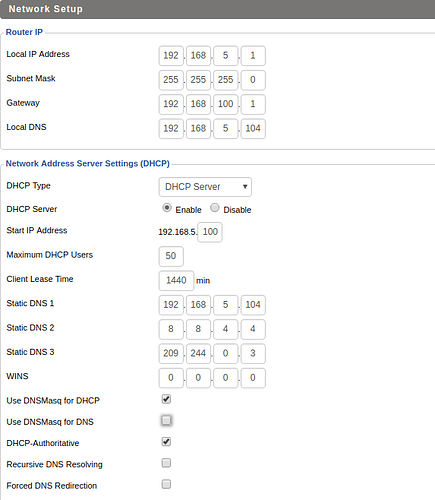

Hello there . I really need your help guys .I cant make pi-hole to work from 2 days now. I have a router linksys wrt1200ac with ddwrt installed and probably there's some setting that cause a conflict even if i didnt remember to have change something in the last 2 months. I tried reinstall pi hole , change even the rom of the raspberry(from osmc to pidiet) but nothing. After i have configured it when i put to the router the ip of the raspberry as dns , the pi hole web page doesn't seem to open anymore and even the web interface of the Nas (Network error occurred. Check your DNS and network settings) and plex isn't accessible anymore too. I tried change some settings on the router but i didnt seem to understand good what are all the DNSMasq options so i attach 2 screenshots with my configuration. After i put the google dns on the router page all devices seems to work again .If it can be helped (i don't know if it can affect in certain way) there's also a vpn configured with Policy based Routing for certain clients in the router. i cant even ssh in the raspberry . From the raspberry . I checked /etc/dnsmasq.d/01-pihole.conf and the nameserver with 8.8.8.8 are there. Moreover if i dig www.google.com it seems that is resolved without problem . I'm almost sure that the problem is a ddwrt. Someone can give me his lights? Im really desperate to make it work again without installing pi-hole on the nas as the i loose the hibernation option then.

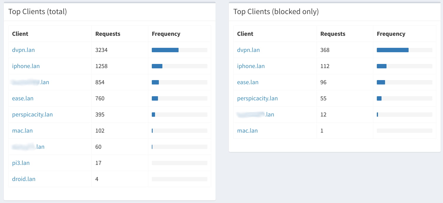

I am also using ddwrt and got it up and running but the new dnsmasq support 4.0 has introduced has me excited about getting getting more detailed reports from individual clients rather then them all look like they're coming from the router itself.
Yes, I wrote that :slight_smile:
If you set it up as shown, individual requests do indeed get logged as such. That has been the case before version 4 though.
