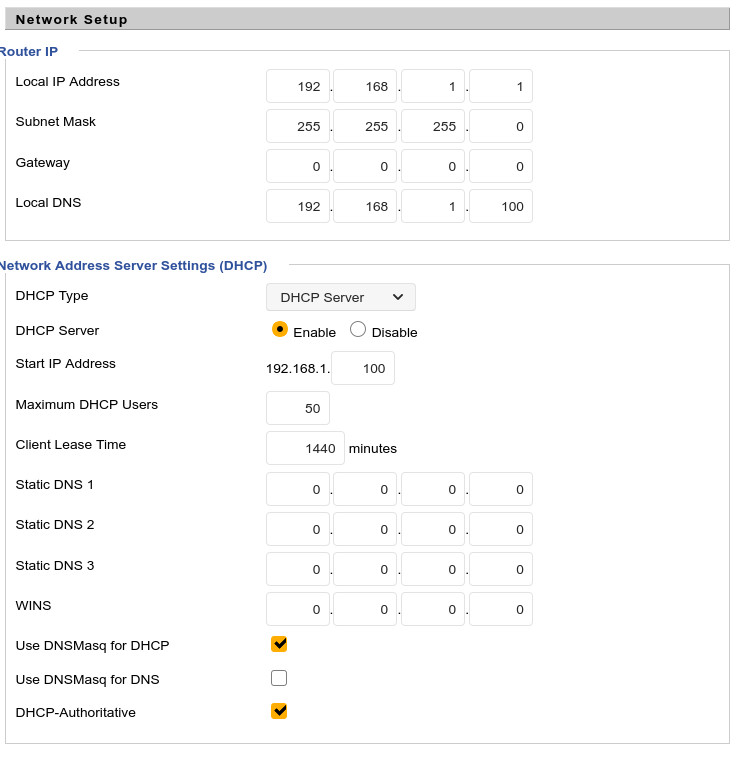

I'm using an old version of dd-wrt and never got the dhcp-option=6,192.168.1.250 option working.
But I got it working by following this topic.
What I did was unchecking "Use DNSMasq for DNS" (under Setup) and "Local DNS" (under Services).
Then I put the pihole IP under Network Setup -> Local DNS, and not under Static DNS 1.
