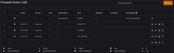

I'm getting back to you with my tests to checkout if Zerotier works in a similar network as your company and the result is yes it works but a bit slower than a direct route (it was expected).
Here are my firewall rules on the local network:
If I ping a device (hosted in Europe) inside my virtual network I get a ping of around 210ms, probably because the Zerotier root servers are located in the USA and I'm in Europe so depending on your location you will probably have a lower ping than mine:

So for the DNS requests I get around 0.5s of response time:
user@ubuntu:~$ time nslookup google.com 192.168.192.10
Server:		192.168.192.10
Address:	192.168.192.10#53
Non-authoritative answer:
Address: 172.217.168.206
Address: 2a00:1450:400e:80c::200e
real	0m0.487s
user	0m0.015s
sys	0m0.014s
Which is not bad compared to without the firewall restriction:
real	0m0.100s
user	0m0.019s
sys	0m0.009s
So in conclusion, there is around 400ms of additional latency (in Europe) when running Zerotier behind a very restrictive firewall but Zerotier can really work in every network.
