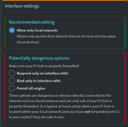

The "Listen on All Interfaces" does not show on my PiHole Settings.
Should one of these be selected?
When the above articles were written it was worded as Listen on all interfaces, permit all origins. Now it's worded as Permit all origins.
Thank you. That worked but I ran into another issue. PiHole is filtering as expected on cellular connections but now any App I have that needs to communicate with devices inside my home network (like Ring) aren't working. Any ideas?
