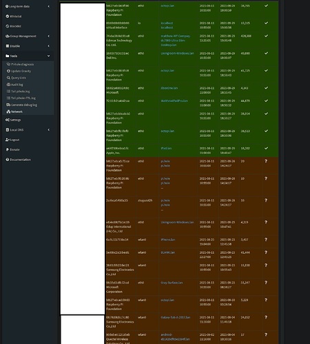

I am running Pi-hole v5.4 Web Interface v5.6 FTL v5.9 on a RPI 3 B+ and have all my zerotier setup and can see all devices as active and connected as well as Listen on all interfaces, permit all origins selected. I had all this working and able to block even when not connected to my home network. I had something go wrong with my network so I reinstalled everything and tried it over but cannot get it to work when away from my home network. I very well could have set this up wrong as I am not very knowledgeable about network stuff. Hopefully someone can glean information from my debug log. And yes I have scoured the net and read almost all post pertaining to setting up pihole and zerotier from about 2019 to present and am still confused. I know zerotier is working properly as I can SSH into the pihole and connect to the dashboard away from my network as well as connect to my instances of octoprint while away from my home network. I apologize if this is something very simple please do not be rude as my knowledge base is not in networks. I followed this guide here just like last time.
Not Blocking ads when not connected to the home network.

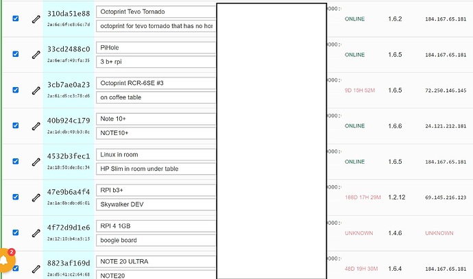

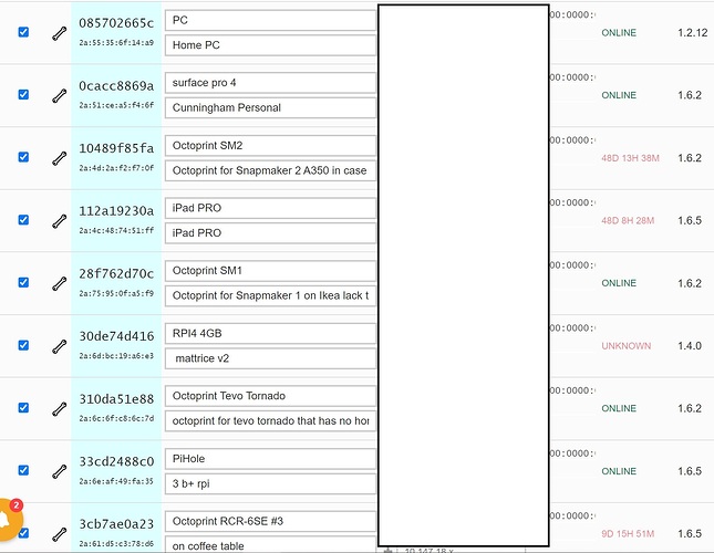

I am currently away from my home network on both my laptop and my cellphone each are online and connected to my zerotier VPN as is my pihole. I am currently not getting any ad blocking or even showing these devices as connected to pihole for ad blocking while being one hop away from my home network. I am just trying to get all my VPN and pihole to work while not connected to my LAN. As you can see I have all my devices I want connected to my zerotier account pihole, Note 10 + and the surface pro 4. I am able to SSH into my pihole RPI while I am away and not connected to my LAN which makes me think that I have setup something improperly on the pihole side since i can see all devices i want online in zerotier but cannot see them connect to pihole like i can when they are on my LAN.

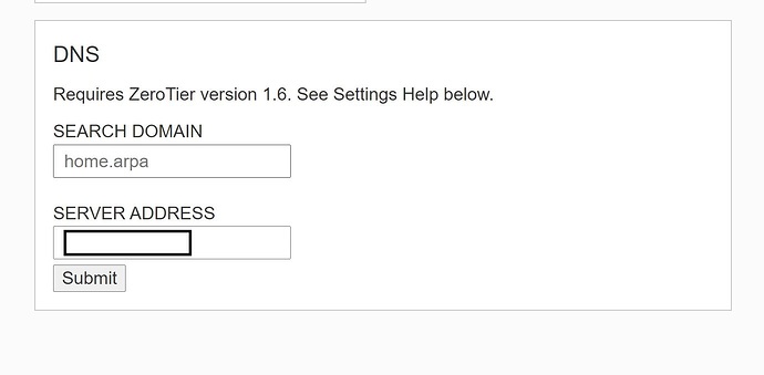

Did you add your pi-hole ZeroTier IP under the DNS on the ZeroTier Central?
I do not think I have done that step, do you mean adding this IP from here.
And placing it here.
Yes
I have just done that this morning let me reboot the system and see if it has helped.

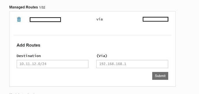

I have added the above mentioned IP's to the place in the photo but still have not gotten connectivity. to the aforementioned devices I did notice something odd maybe its just my lack of knowledge with networks (I am not at all knowledgeable when it comes to anything network related) there is a section on zerotier about managed routes and mine looks like this. I deleted the route but then I could not connect to anything that was on my zerotier account even if it was showing as online. https://tricorder.pi-hole.net/GvBdwkXV/
