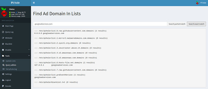

@DL6ER here is the output of the command you requested
$ pihole -q googleadservices.com -exact ::: /etc/pihole/list.0.raw.githubusercontent.com.domains (1 results) 0.0.0.0 googleadservices.com ::: /etc/pihole/list.1.mirror1.malwaredomains.com.domains (0 results) ::: /etc/pihole/list.2.sysctl.org.domains (0 results) ::: /etc/pihole/list.3.zeustracker.abuse.ch.domains (0 results) ::: /etc/pihole/list.4.s3.amazonaws.com.domains (0 results) ::: /etc/pihole/list.5.s3.amazonaws.com.domains (0 results) ::: /etc/pihole/list.6.hosts-file.net.domains (1 results) 127.0.0.1 googleadservices.com ::: /etc/pihole/list.7.raw.githubusercontent.com.domains (0 results) ::: /etc/pihole/list.preEventHorizon (1 results) googleadservices.com ::: /etc/pihole/blacklist.txt (1 results) googleadservices.com
Indeed, it seems that googleadservices.com was already in several lists.
As I said though, to be honest it is possible that I had misconfigured something before, or that I didn't wait long enough for all the changes to propagate correctly.
