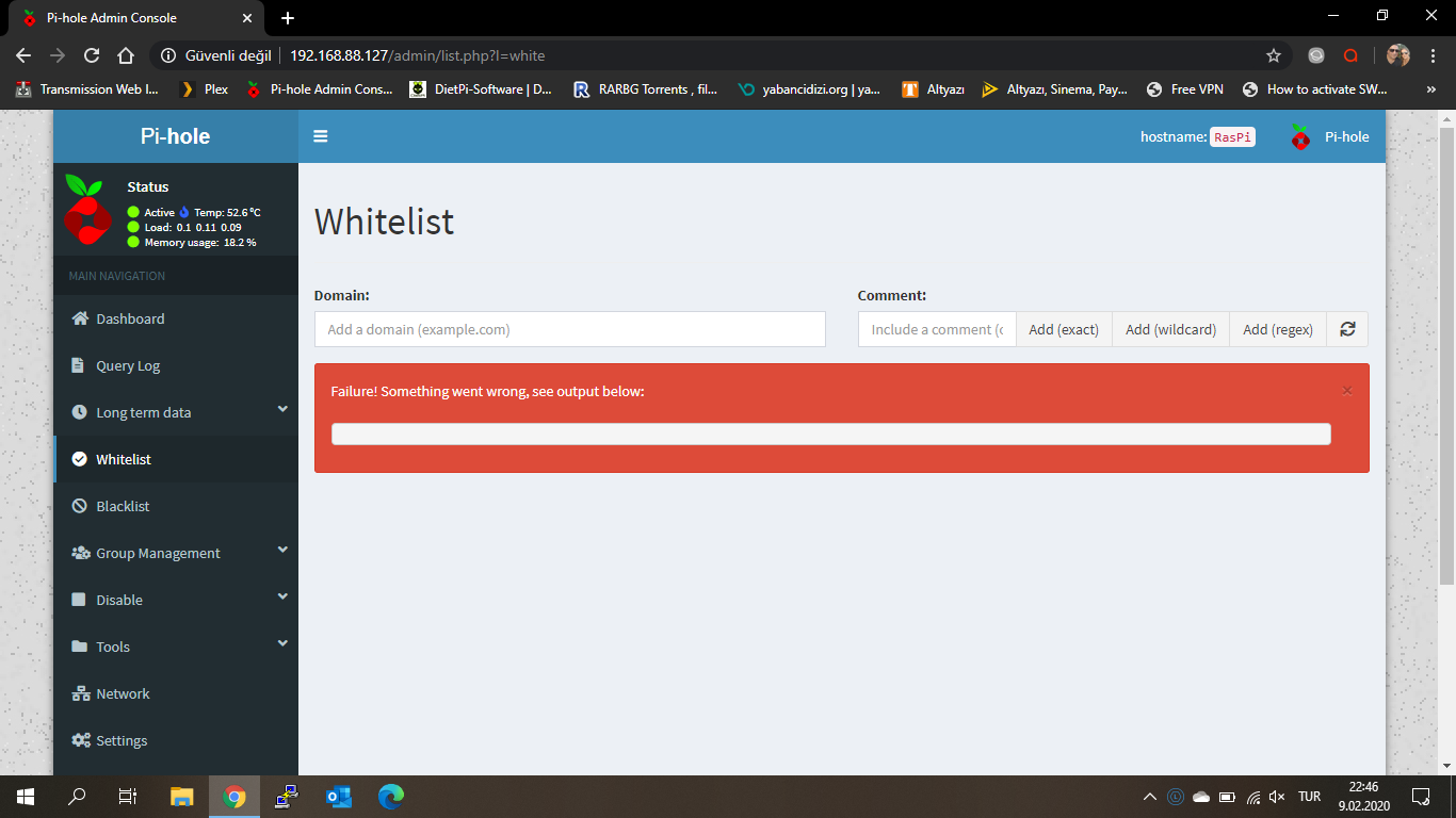

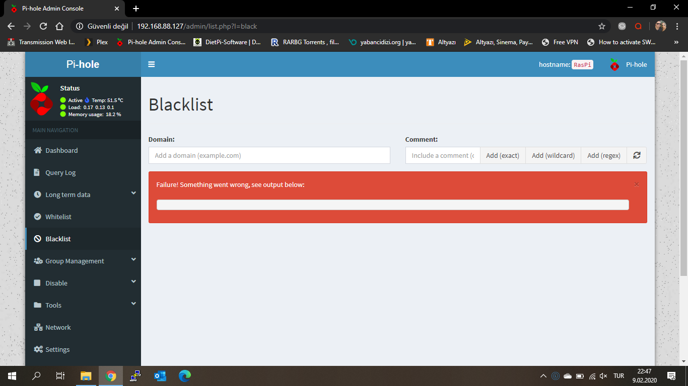

Problem with Beta 5.0:
whitelist and black list Failure ?
Help needed,

@murtyolcay Please try force-refreshing your browser's cache (typically achieved by [Ctrl]+[F5]).
Thank you for quick response,
I did force- refresh and clear the cache and also i have tried other browser with thw same result.

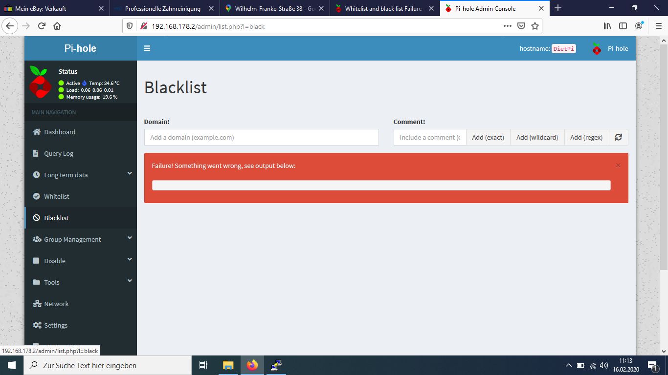

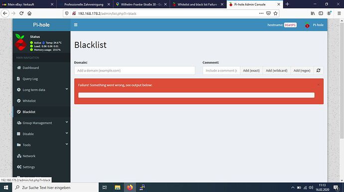

Hi, I have got the same problem - I did everything like adviced... php-intl is installed - still does not work -need some help - great software anyway :slight_smile:

Also in my case the Whitelist and black list Failure is still there.

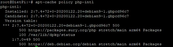

@DL6er, Thanks for all the support! When running "apt-get install php-intl" the php7.4 version was installed, while the extension_dir in http://pi.hole/phpinfo.php points to the 7.3 version where indeed the intl.so file is missing. I don't know how to get the 7.3 version installed. (Sorry, trying to find my way in the linux world...)
php-intl is installed.

Is there a package php7.3-intl available for you?
